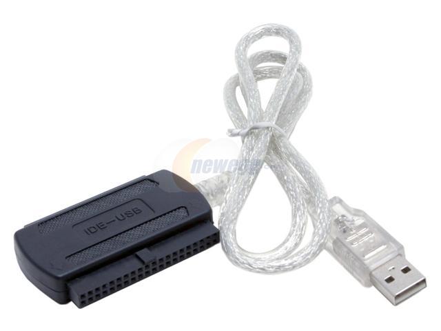

    Something like this is handy if you want to pull data off a IDE drive and you have another computer available to plug it into with a USB 2.0 port: http://www.newegg.com/Product/Product.aspx?Item=N82E16812156101
    It's saved me the work of opening up a computer and temporarily wiring in a hard drive. It comes with a power supply also.
    For a SATA drive, you don't need a adapter. You just need a available SATA socket in the computer, a long enough SATA IDE cable, and possibly a 5 pin SATA power to 4 pin Molex (Most other hard and optical drives) power adapter and you can use the power adapter from the above device. Or there are SATA versions of the above adapter if you want to use a SATA to USB interface.

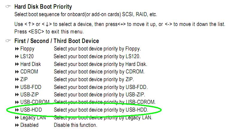

  17. I got one of these, the only problem is I can boot windows off the Harddrive.
    Any advice ?
  18. Mod Neophyte redwudz's Avatar
    USA
    I've never tried that, but I think your motherboard would have to be capable of booting from a USB device. I have a couple of MBs that seem to have that capability.
    I'll attempt to give it a try. Hopefully I have a spare hard drive around that has the OS on it. Or I could unplug the IDE cable from the boot drive on one of the computers and route that through the unit to USB. That would at least give me the MB drivers and a known working drive. Give me a couple of hours and I'll try it.
    EDIT: I used my Vista computer as it can boot from a USB hard drive. This from the manual for boot options:
    The only functional hard drive with a OS on it was one with Ubuntu. But it booted with no problems. The installed Linux drivers were wrong for the motherboard, but otherwise it would have worked fine. I also booted from a Windows PE disc on a CD drive plugged into the computer with no problems.
    The one Windows boot drive I had gave me the 'ntldr missing' error. I probably could have fixed that by copying a similar one from another computer or just sticking in the XP CD, but I didn't want to mess up my Vista install. So the answer seems to be a qualified 'yes'.
