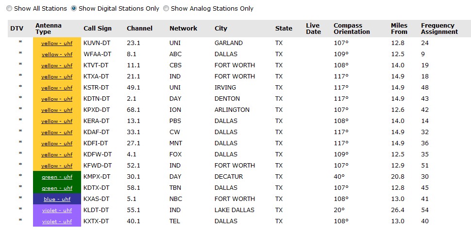

	Here are your digital transmitters. Most about 15 miles and 108 degrees. All are UHF except WFAA (ABC) on VHF 9. An indoor antenna may work. Analog cheannels will be turned off on Feb 17, 2007
