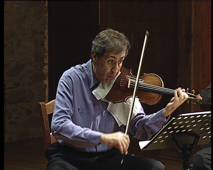

The cameras are Panasonic E600 from January 2004, seem more prosumer to me (whole equipment with 3 cams and fully equipped control room cost approx. 90,000 EUR).
The artifacts look to me like displaced single pixels, especially around shapes with strong contrast but do not seem to depend on motion (I also saw them in the still background of the picture). Although they seem to move with the shapes they depend on.
At the moment I can only add a picture captured from my computer where everything looks OK since I did the testing on the big screen in a shop and have no equipment to grab pictures from a TV (I could take a photo if that helps).
What I don't understand is that it looks good on one TV and really appauling on another. Makes me feel very insecure...
Thanks and best regards,
sylvanez
screen.png -
I'm not sure. The 3CCD camera outputs analog. How did you capture? The frame grab seems to have over sharpening where noise is elevated but that may not be the main problem. Did you use filters in Premiere? It could be monitor settings.

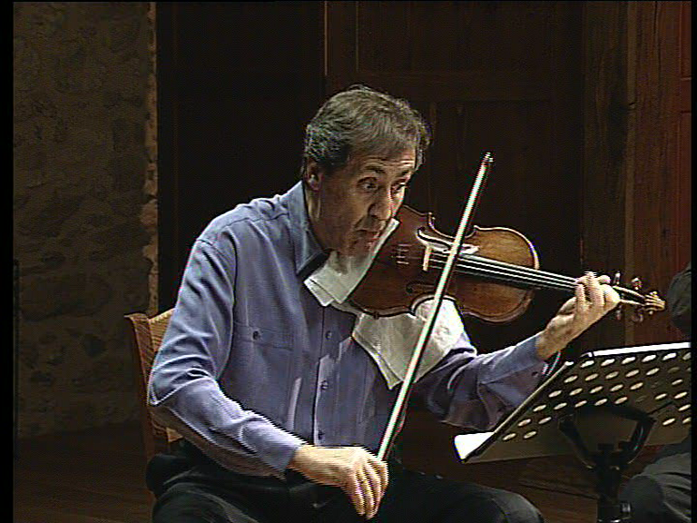

Deinterlacing is from PowerDVD (I think blend is standard method here).
Here is a screen from the same video played with VLC Media Player. How do you see the over sharpening? The red and green shimmers in high-contrast areas? Can this be the problem?

Oversharpening has caused noise to show as grain in smooth areas like the face. Oversharpening also causes analog PAL/NTSC decoders to false detect luminance grain as color when the frequency crosses the 4.43 MHz (3.58 MHz. NTSC) subcarrier frequency. S-Video connection should eliminate the false color issue.Originally Posted by sylvanez
The false color is a clue that oversharpening may have occured in the camera. You say some monitors display as smooth, others this way. Maybe the "smooth" monitors are lower quality and lack ability to display higher frequency detail. This is why a high quality monitor should be used for camera adjustment. -

The over sharpening has not only created additional noise but overshoot and undershoot at sharp edges. Note for example the bright and dark bands at the boundary between the white cloth and the violin. You need to determine where in your processing this over sharpening is occuring. In the camera? The FireStore? Premiere?
You can undo the overshoot with a blur filter. That will also reduce the noise. You can get more noise reduction with temporal noise filtering. But these techniques generally doen't work well with interlaced material. And of course, the result is a blurry image. It's better to avoid the oversharpening in the first place.
