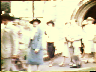

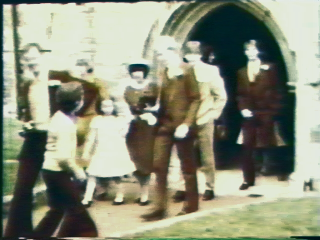

    Not sure how to resolve this issue. There seems to be a lot of blue and not a lot of other colour. I am begining to think it can only be saved by taking the colour out completely, but in certain frames you can tell ther correct colours are in there somewhere. Please advise!

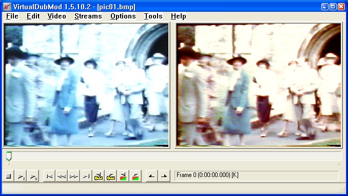

    It's an old video you've got. What capture device did you use ? Is the video source correct when it's viewed on TV or is your snapshot like original ? It seems to be very bright and unfortunately it is difficult to find a way to solve this issue.
    I don't know if there's a video software which includes a filter called "chromatic correction" : you said sometimes you had colors that appeared. And I tried to correct a little your snapshot with an imaging software. See the result yourself.
    Voilą, I 've given you few hopes.
  3. VirtualDub's ColorMill filter can do color corrections like titigrom posted.
    I don't know how you're capturing but if you can do anything to reduce the over bright captures you'll be in much better shape. Otherwise, you can bring out a little more detail in the overly bright areas by changing the luminance while the video is still in the YUV colorspace. AviSynth can do that with the ColorYUV() filter.

    My attempt looks about the same as titigrom's. I put it in VirtualDub Mod and used the ColorMill filter: http://fdump.narod.ru/rgb.htm The brights are way too high and there's not much there to work with. Of course it's different with a video as it's changing all the time. I would give it a try though. You may at least get the colors a little closer.
    EDIT: And to get those results, I just played with the different settings. Nothing scientific or ordered.

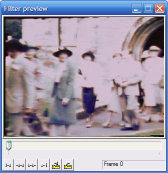

    here's a little screenshot of the sort of results i'm getting with colormill
