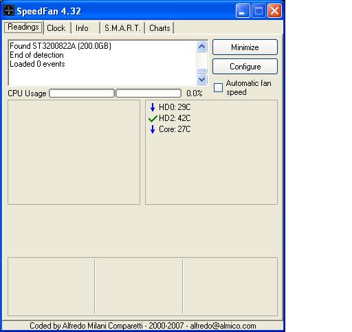

  17. I agree with jagabo, did you notice the image I posted showing speedfan running and indicating 27c. It should show drive and CPU temp. BTW that 27c was after a hour or two of running.
    The newer Dual Core AMDs or the Intel Core2Duos run much cooler and quieter. That heating/noise is why the chip like yours are cheap to buy. They ran very hot. Make sure it is really running hot by feeling the heatsink.
    The fan ramps up in speed as the CPU temp goes up. Also be sure the CPU heatsink is properly mounted.

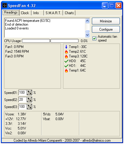

    Recently I've had my computer re-boot here or there while doing video encoding. It doesn't do it all the time (very hit or miss) and only did it a few times within the past few weeks or so ... perhaps because it's summer and even though the room is has a window A/C it can still be a bit warm in that room at times.
    I decided to download SpeedFan and this is what I get but I am not sure what I am "seeing" here:
    I take it that those little fire icons are a bad thing?

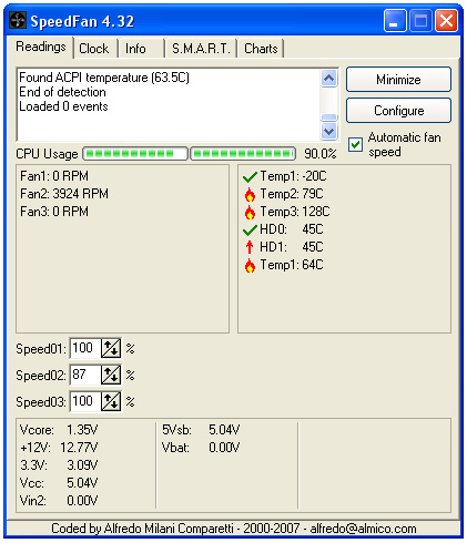

    After I killed CCE SP and waited a few moments the fan slowed down and here is another screen shot:
    Again this was only a couple of minutes or so after killing CCE SP and allowing the fan to slow down etc.

  26. John , Something way to hot, put a finger to the various heatsinks and see what one is the culprit. Could be CPU, Chipset or.....
    If those are real temps, 128c is over boiling so be carefull not to get burned.
    Overheating will cause funny things to happen.
    It is also possible that it is only remotely related to summer heat. It could be dust buildup in the heatsinks.
    I seem to remember MSI has software to monitor their motherboards. That should give a result telling what is running high. You may have to go to their download site for it, I do not remember if it is on the Drivers disc.

    This computer I have now is a store bought model which I got at the end of 2005 and I've never had issues with it until the past few weeks when I found it would re-boot while encoding and I figured it had to be a heat issue.
    Unfortunately this MSI board is an orphan ... from what I've read it was some sort of OEM board that MSI doesn't like to pretend exists ... it's not on their support website ... others have confirmed that finding out much of anything about this board is next to impossible.
    There is a local computer store here ... a mom and pop kinda place ... and the guy that runs it has a local Saturday AM radio show about computers etc. so maybe I'll take it there and have them look at it. I've heard him on the radio and he seems to know his stuff. Maybe they can check the heatsink and replace it or put some silver compound stuff on it or whatever needs done LOL
    Not really something I want to mess around with on my own.
