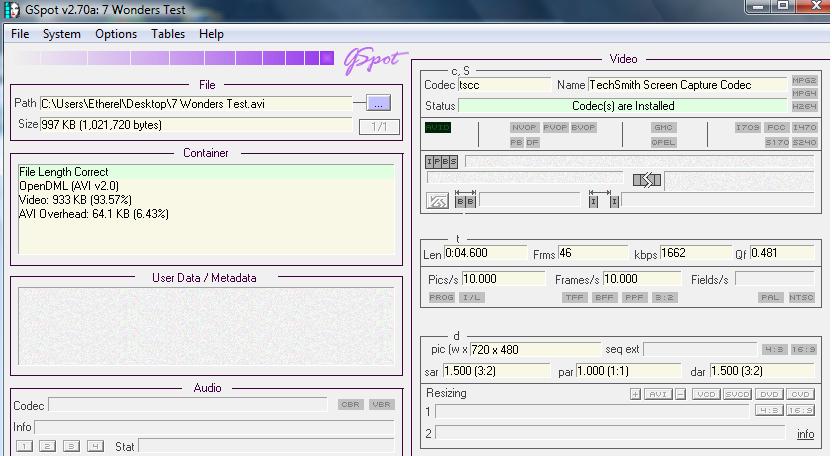

ok, heres the screenshot. I looked up the codec name and found what I think was the source, they make a program called Camtasia, that captures video of your computer. Don't know if that helps.

Womble is really designed to edit mpeg video. While it can do avi files, it can only edit them if an older style video for windows (vfw) codec is available. It appears that the Techsmith codec that Camtasia uses is a directshow codec, which Womble cannot use. If that is the case (and I cannot confirm it, however g-spot says you have Techsmith installed and Womble won't play ball) then you will have to use a different editor.
