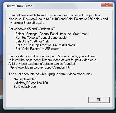

  1. i keep getting this error telling me that my laptop couldnt change resolution to 640x480 and tells me to change to that setting as well as set the monitor colors to 256. i have windows vista and i have tried everything, installing it couple times, no go. right click properties and compatibility tab and no go. if i change to windows 95 it tells me that the cd is no in the drive even if it is. its making me mad cuz one of my friends has the same laptop (toshiba A250) new customized and the only diff is the video card, mines ATI 2400 hd and his is nvidia go 7300 (r something like that) and it runs fine in his computer, any help will greatly be appreciated.

  6. heres the picture of the error message.

    Yes , the warning says you have not made the applicable changes to run the game ... but your current video drivers don't know what 640x480 is ... the dna or omega drivers may resolve the problem and give you the option to set 640x480 , 256 colour .

  9. OHH YESS!! i updated the drivers and used the ones from "driverheaven.net" and stabingo!!!! it worked!! i tried dosbox and nothing, tried the DNA and Omega drivers but werent for vista and these driverheaven.net drivers were a miracle to com accross! now im running starcraft w/o the videonimo error! thanx a lot amd/ati for all you help (...NOT!)

  12. hey i did fix this problem, http://www.driverheaven.net/modtool.php has the drivers, follow the steps they say in there
    1- download the latest ATI drivers( i suggest from driverheaven directly and not ati.com)
    2 - follow the steps on there and everything should work great!
    let me know if you have any problems installing them, make sure you read the steps carefully and do as they say, they are pretty easy to follow and do make sure you turn off UAC cuz that can mess up a lot.
