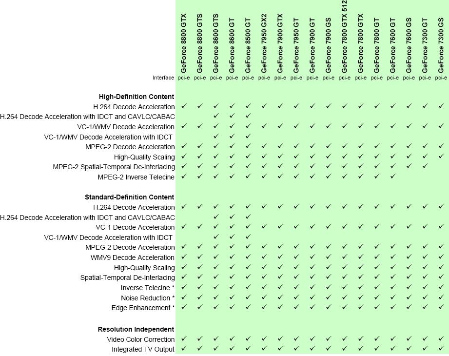

Ignoring gaming, the display card plays a role for decoding video, video output, deinterlacing and scaling. You will want a card with NVidia PureVideo or ATI AVIVO capability. All PureVideo cards are not created equal. Only a few of the highest end cards support AVC h.264/VC-1 decoding and current cards still lack the ability to fully decode AVC without loading the CPU. I've been delaying purchase until the card can do the full job but recently had to add one more card so I settled for a 7600GT for now.
http://www.nvidia.com/page/purevideo.html
http://www.nvidia.com/page/purevideo_support.html
download the PDF
Higher end compositing and effects software use OpenGL cards to add vector wireframe preview support. See the Quadro cards. -

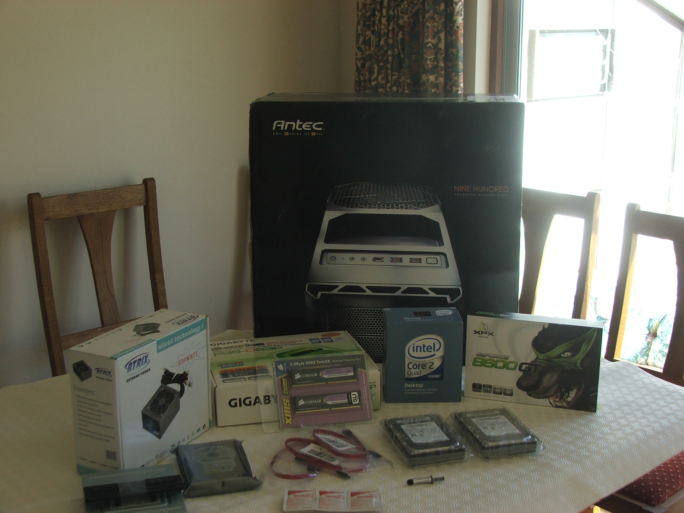

This is a wierd coincidence but I built a very similar system for myself this weekend:
Antec Nine Hundred case
Intel Q6600 2.4Ghz
Gigabyte GA-P35-DS3P mobo
2x1Gb Corsair DDR2 6400
XFX 8600GT
1x160GB WD Caviar SATA
2x500Gb Samsung Spinpoint SATA
It absolutely flies. I can't max out the CPU even with two separate windows of VirtualDub doing encodes on normal priority
IMHO:
1) I'd stick with 2Gb of RAM since I think you're unlikely to notice the benefit from the extra 2Gb.
2) You don't need the 8600 GTS for desktop work - as pointed out previously, a 7600GT will suffice. However, the price difference between the 7 and 8 series is so small you may as well got with the 8.
3) I'd also be tempted to go with a normal HD instead of the Raptor. I was going to get one myself, but the benchmarks don't justify to price premium.
Following the above, you should be able to save about 300E.
Try www.dabs.com - if you register for their e-mails, they send you some e-vouchers. I got £20 off my purchase which was £660 in total.Regards,
Rob -

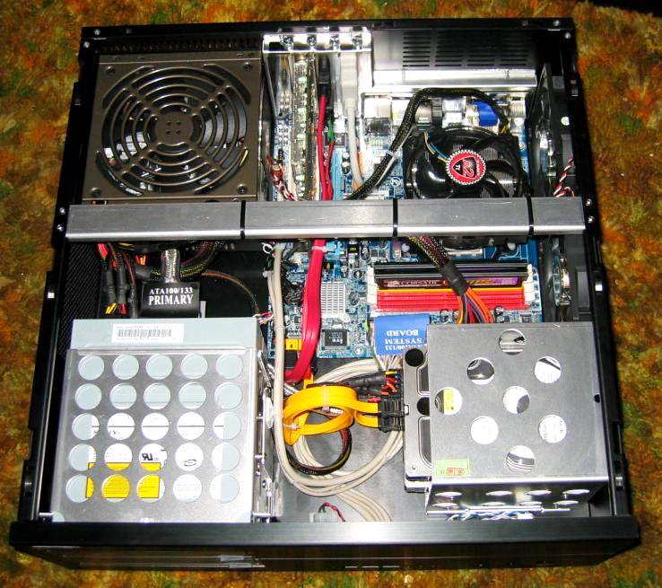

I just finished putting together a new HTPC myself. Lain Li desktop case, 5200+ AM2 Athlon X2 running at 2.8Ghz at present, using a Thermaltake TMG cooler. 2GB Corsair XMS DDR-800 RAM, two WD 320GB SATA drives, Thermaltake 500W PS. Very quiet. I changed out the case fans for Enermax 120mm's, but I still think I may slow them down about 75RPM as they are the only source of noise, though minor.
CPU is 27C at idle, case is 32C. I'm still adding software, so I haven't encoded anything, but CPU temps should still stay ~42C max. Since it's a HTPC with a HDTV tuner going out to a video projector, I used a uATX MB with on-board video with component and HDMI out, a Gigabyte GA-MA69GM-S2H. So far I'm happy with it. A few finishing touches and it should be ready to go.
That's some mighty nice cable bundling! I like Lian Li cases a whole lot. Aluminum, but thick.
redwudz I was wondering if you got your newest HTPC built. Nice setup in that Lian Li case.
If only I could make my cabling nice and neat like yours!
That case helped a lot with the cable arrangements. I was able to run some cables under the raised drive platforms to keep them out of the way. The modular power supply helps also. I cut off the unneeded PS cable ends.
For a aluminum case, it's surprisingly sturdy with no flex. Desktop cases are usually easier than tower case for cable arrangements, but it took a bit of trial and error to clean up the cables.
I added a dual external SATA connector for SATA and E-SATA external drives. -
