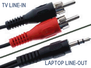

Im sure your laptop has Audio-OUT, and your new TV has Audio-IN.
Those are the ones that need to be connected (usually round headphones type plug for lptop, 2xRCA type plugs on the other end for tv) like this:
