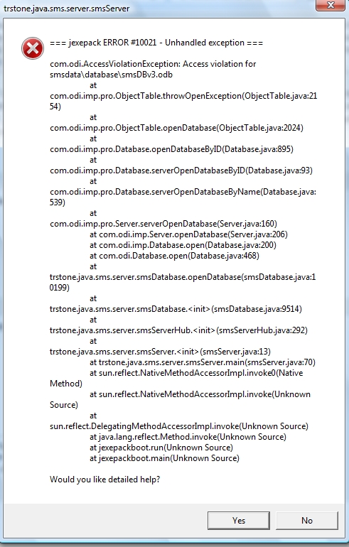

  14. dunno if related to this thread.... I cannot find the help anywhere.
    I do have a HP loaded with Vista. I own Rosetta Stone original v2.1 has 3 CDs (application v2.1A, Student Management System V2.1.1HS, Spanish Level 1)
    here is the guide I used: https://secure.rosettastone.com/us_assets/documentation/HS_SMS_QS.pdf
    I encounter an error on the "Enrolling Students" part of the Set Up. I see the "server" running, but immidiatly I get the following error (I have updated my jave, I have the latest)
    Also only ONE time the error said that
    Port 8080 is already in use.... I went to my task manager (dunno where else to look) and I didn't find any PID with 80 anything.
    Thank you!
