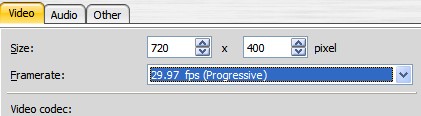

It is not DV and it is not HD. Here is what happened, your shooter selected 480p60 mode, which is a rarely used HDV format. So you do have 480 progressive frames at 60 rather than 30 of standard NTSC. Do do not need to deinterlace.
Just have Tmpgxpress convert it to 29.97fps progressive- 720x400. I'll post a screencap later of the setting, but it is in the output formats setting.
