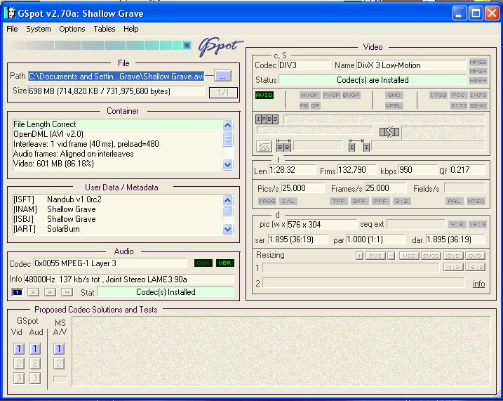

Original file is a DIV3 with report of codec is installed.
Its telling me nothing more than I already know.
The file is a few years old abd doesn't explain how this problem with TMPGEnc is occuring.

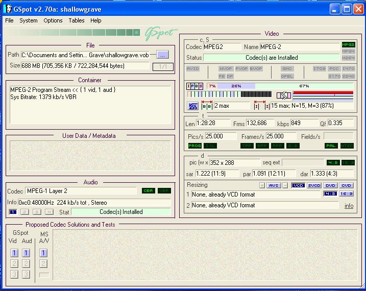

What GSpot says about the VOB file...
Video: MPEG-2 Program Stream << { 1 vid, 1 aud }
Sys Bitrate: 1379 kb/s VBR
Audio: MPEG-1 Layer 2 0xc0:48000Hz 224 kb/s tot , Stereo

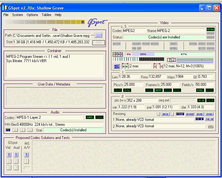

What GSpot says about the MPG file...
Sys Bitrate: 7711 kb/s VBR
Both files are high quality, both are MP2, both have different file sizes and TMPEnc DVD Author bitches about the VOB file but not he MPG file but both are MP2 files at the end of the day.
It as you can see does not make any sense. -

Gspot also has two bitrate values it can show, one under the "Container" window that you recently posted values for both files, the other bitrate value is right next to "Len", "Frms" right in the box next to "kbps" which is the average bitrate, which is more informative than what is shown under "Container" window.
Its not out of the ordinary for the MP2 file to be 1.41 GB if the bitrate is around 7000kbps, from what I can see, this seems to be a correct conversion with the correct header...therefor its not surprising that TMPG works for this file...While your other file is questionable.
