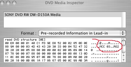

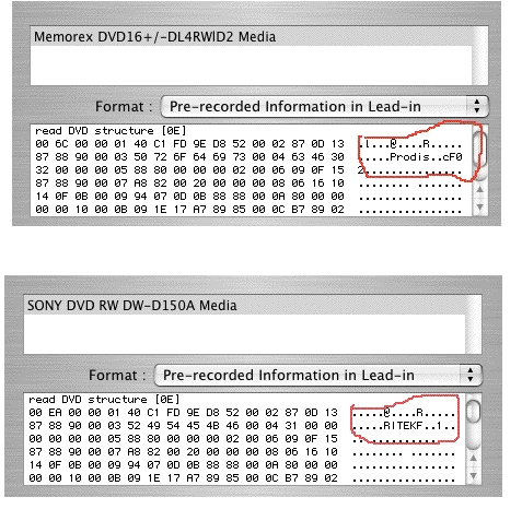

1. DVD media inspector results on the older Maxell is the 1st .jpg below
2. DVD media inspector results on the newer Maxell is the 2nd .jpg below
No.1 is Prodisc?
No.2 is Ritek?
Is this what your looking for?
sknoxx
https://www.videohelp.com/dvdmedia?dvdmediasearch=Maxell&dvdmediadvdridsearch=&type=11&...+or+List+Media
looks like u got a bad quality media.
my condolences -

Yup found Verbatim at Office Max $19 for 50 (Note: the packaging labling on the ones i got are different so i bought a spindle with the lable they normaly used and one with the new one.
Here are the media code from each.
