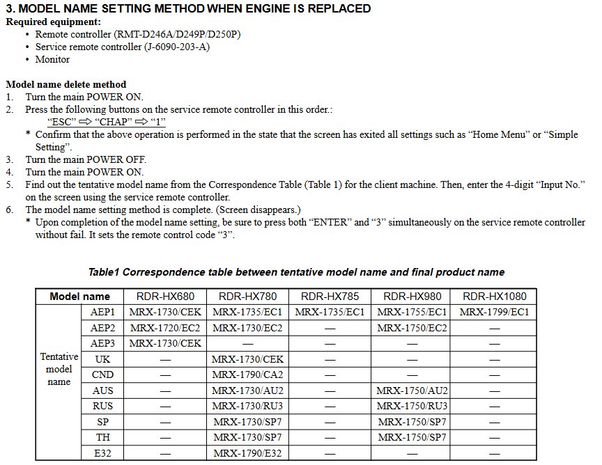

    According the service manual there is a possibility to reinitialize the DVD recorder with a different model number:
    [Attachment 83926 - Click to enlarge]
    Since I have model AEP2 RDR-HX680, I choose in the AEP2 line, RDR-HX980 column the MRX-1750/EC2 device.
    Completed the procedure detailed in the service manual, with the new HDD installed.
    There will appear a table on the screen where the necessary 4 digit code for MRX-1750/EC2 presented.

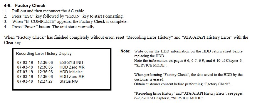

    After this run the factory check described in the service manual:
    [Attachment 83927 - Click to enlarge]
    After the successful factory check I have a DVD-recorder of 250 GB space.

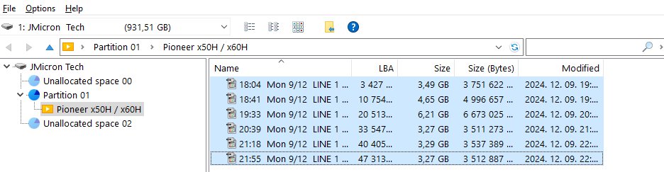

  18. I've experimented further because I've a 1 TB HDD built in.
    Repeated the procedure above, but this time I've selected RDR-HX1080's number during the procedure and the HDD initialisation produced 500 GB capacity with the following format info.
    [Attachment 84049 - Click to enlarge]
    If you have a 500 GB capacity HDD then You can stop here and set back your SONY device to it's original model number, described above. The HDD capacity will stay 500 GB.
    If You have a 1 TB HDD do not revert back yet, you can achieve using the full capacity but the process is not for everyone!
    Take out the HDD from the recorder again and connect to your PC. Get a disk editor for your liking, I've used Active Disk Editor from LSoft.
    Follow the procedure from this post by XXCross.
    When You put the HDD back there will be 1 TB accessible meaning 147h55min in HQ+ mode.
    And now You can change back the model number of Your device with the procedure described above.
