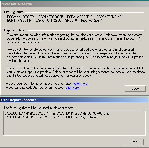

I have a USB printer that I always keep unplugged from the power and disconnected from the PC and only connect it when I need to use it. I never had any issues for years. Now whenever I plug the printer's USB cable to the PC, Win XP crashes with a BSOD and reboots, triggering an endless loop of BSOD and reboot unless I disconnect the USB cable in which case Windows starts normally again and reporting an error. I tried reinstalling the driver with no success. Any ideas how to fix this? Thanks.

what error are you getting on the BSOD? could be drivers, or a faulty printer or cable...

Yes, the USB scanner is connected to the same USB hub (I use a Belkin USB Hub) and it works fine. So it could be either the USB cable from the printer or the printer itself?
I just tested the printer and cable with the same computer but with a freshly installed WinXP (I used another hard drive for this) and the printer works perfectly, so it must be a software issue in the original hard drive. I uninstalled/reinstalled the drivers and HP software with no success. Any ideas? Thanks.
Yes, I tried connecting the printer directly to the USB port in the PC and same problem. As I said, by freshly insstalling WinXP the issue is solved, so it's a software issue with my current OS installation rather than a hardware issue (printer, cable, USB hub, etc). I tried as I said uninstalling/reinstalling the printer drivers/software but the problem ersists. I would like to find a fix before having to reinstall WinXP. Thanks.
you can try forcing widows to re-install the usb drivers. first unplug ALL usb cables and devices.
Go into Control Panel\System\Device Manager and uninstall anything you find under "Universal Serial Bus Controllers" after clicking the "+" sign.
reboot
after they are found as new devices and reinstalled go back to the device manager and check for any listed as yellow or red. if there are any you may need to reinstall the motherboard usb drivers also.
