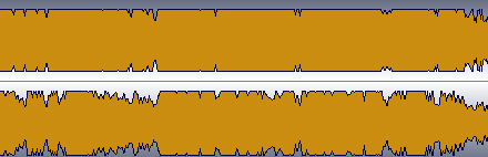

guyz recently i attended a concert. recorded the concert using a sony hdd handycam. however the audio of the video has too much bass in it. alot of 'booming' in the audio. sounds terrible.is dere any where i can remove the bass?thanks guyz.
k guyz the sample of the audio,pls help guyz thanks : http://www.fileden.com/files/1927/nicky.mp3
Problem is that the bass has clipped the mic preamps, and recorded the clipping - you might have been able to take the bass out, if the recording had not clipped, but you can't take out the distortion - start again job I'm afraid!
If you are using the on-camera mike in a loud setting, try putting a band-aid over the mike to lower the level a little. The fabric band-aids work the best.
I know it sounds strange, but works well most of the time. And don't sit too close to the speakers without earplugs.
Wow, that sounds bad. No way can you remove that distortion. Not trying to be negative, just saying. Clipped beyond repair.
