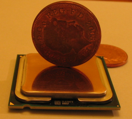

It's done. And, I'm sure, you'd like to know what happened. Does my E6600 have wings and a halo?
No. It certainly doesn't. Photos will follow tomorrow (it's a bit late tonight, and it's been a long, hard day at work) but my IHS was pretty concave - this is normal enough for Core 2 Duo IHSs. I worked away all the nickel plating from the IHS, then began polishing the copper underneath. I didn't manage to bring it up to a perfect polish with only 1500 grit paper to work with, but it's close enough.

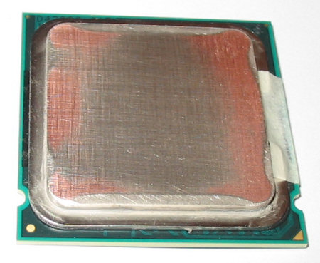

- Begin with the 320-grit sandpaper, rubbing in circles - don't apply pressure, just let the weight of your hand and the sandpaper do the work. Every few seconds, rotate the CPU 90 degrees.
- Notice how it rubs off unevenly? The first bits to turn copper-coloured are the high points. Most Core 2 Duo CPUs are concave - the centre is lower than the edges

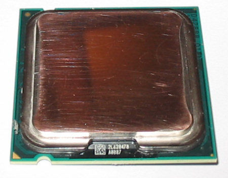

- Once all the nickel is gone, switch to the 600-grit sandpaper. Rub in a combination of circles and straight lines. Again, no pressure on the CPU - allow gravity to do the work. Keep going until you're free of all the big scratches
- Move on to 800-grit sandpaper - this will simply polish the CPU up a little
- Move on to 1500-grit sandpaper. If this is the final stage, be very gentle and aim for the smoothest finish you can. Don't worry - you won't get rid of all the scratches and it won't be a mirror, but it's OK. That's what TIM is there for.

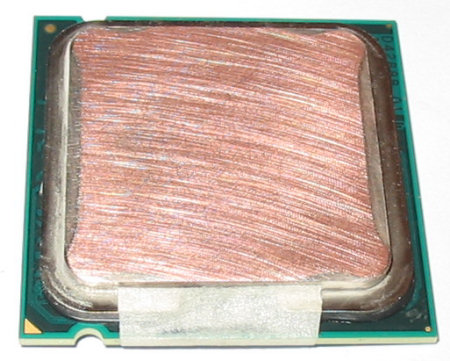

Your CPU will now look something like this:
Clean up all the rubbish from the CPU using isopropanol, and make sure the masking tape is removed. Reinstall into the socket as per instructions (remember to use TIM), boot up, and enjoy lower temperatures!
