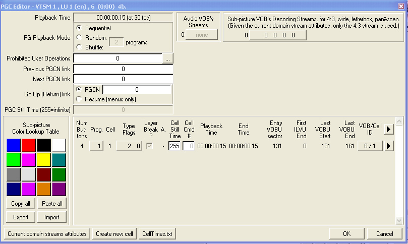

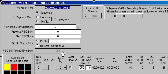

    I opened in pgcedit a still menu that I can't see in my tv and antother one from the same dvd that I do see in my tv.
    I'll try to upload both captures. I don't notice any significant differences. They have the same configuration the one I see and the one I can't see in my TV. It's weird.
    This first one is the one I can't see.
    And this is the one I can see perfectly in my TV. What's the difference?

    I would suggest imgburn to do the dl burning as it has facilities to check layer break placement , and can suggest better points if required .
    Leave that 255 thing alone .
    The missing background thing bit me the year before last and is caused by using a single background frame .
    I think they mentioned it should be a minimum of 00.00.00.15 , but there was no guarantee in the final details .
    I'd say , if its pal , the make it 25 frames long , and nstc , in the case of you project , 30 frames long ... never had it reappear since .
    Take that replacement background , and encode it to an m2v ... set to 30 frames , and redo the replacement of background menu again should resolve that problem of missing background .
    Dvdauthorgui includes a simple function to do this .
    Set project type
    Hit CTRL + S
    Locate background image
    Set required frames ... project use's 30
    Let it rip
    Use this new m2v as the background replacement and it will be sorted .

    The other thing noticed is the vob cell id's are different .
    The dl being 6/1
    The dvdrw , and dvdshrink , being 7/1 ... dvdshrink has some capabilities of making changes to navigational commands .
    Vob / cell id's .
    Nav commands calling such things may also indicate a fault with calls made to titles and such.
    In pgcedit , load the dl
    Info > dvd commands > save > to desktop > post here
    I'd say you have a combination of the above faults contributing to the condition .
    Replace the background as explained above .
    Then well take a look at those nav commands , and see if anything stands out as an issue .

    Created projects using still's and this works , but notice where I marked it .
    255 being reflected in two place's .
    I am still curious as to why the id's of vob / cell , reflect changed ids , even though the one dvdshink created works .
    Are you positive you didnt inject your replacement background by accident into a blank cell nearby .
    To change those "0" , where mine shows "255" , load ifo for menu in ifoedit .
    Go to > vtsm_pgci_ut > locate lu menu involved .
    In lower window of ifoedit , drag it down to almost halfway .
    You will see "pgc playback mode" , your's will report "0"
    Double click that 0 , enter 255 .
    Locate any other lu's with issue , save ifo when done
    Pgcedit will now show correct value as 255 in both places ... not that it appears to matter , just nice to be correct .
