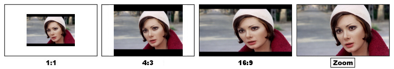

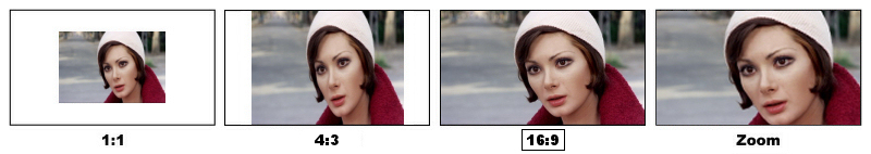

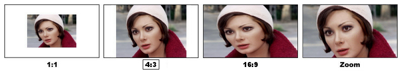

It's because your DVDs are 4:3 Letterboxed. The solution is simply changing the aspect ratio setting on your TV. The TV should have at least 3 settings though what they are called vary by manufacturer. (4:3, Standard, Normal...) (16:9, Wide, Full...) and (Zoom, Stretch...) Zoom would be the right setting for letterboxed videos but not all TVs have that setting, personally if it doesn't I'd get a different TV. You may find some older commercial DVDs will have the same problem and some broadcasts, all widescreen VHS & VCDs... The DVD player should always be set to 16:9 when connected to a widescreen TV. For future discs you don't change the resolution, you set the aspect ratio to 16x9 so you'll be making an anamorphic DVD.
Bondiablo, thanks for your reply and for your illustration. The picture labeled '1:1' is exactly what I'm talking about. But I thought that I had used the 16:9 setting when I did the conversion.
In the future, rather than eyeballing the AVI file that I'm about to convert, should I maybe check it with G-Spot, and then use a setting that matches whatever it says? For instance, if the image looks like widescreen, but G-Spot says that it is 4:3, then I should use the 4:3 setting when I do the conversion, correct? I'll explore that and see what happens with some of the stuff I've got waiting on my hard drive.
About using the aspect ration setting on the TV: There is one, with a choice of 4:3, 16:9, or Set By Program. Choosing the 4:3 setting does make the image fill the screen more, but it also squashes it in at the sides so the actors are taller and thinner. Using the 16:9 setting makes the image smaller, but keeps the correct proportions. -

Here is how a DVD should look at the different settings on most widescreen TVs. I don't know what program you use to make your DVDs so I can't say what settings you need. I use TMPGEnc and with it the important settings to make an anamorphic DVD from an AVI are, on the Video tab set Aspect Ratio to 16x9 and on the Advanced tab usually set Source Aspect to 1:1 and Arrange Method to Full Screen Keep Aspect Ratio but those 2 can vary depending on your source file.
Full Screen
Wide Letterboxed
Wide Anamorphic
