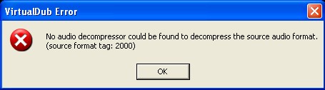

    6. I push the play on the input side and get this
    *** No audio decompressor could be found to decompress the source audio format.
    ( source tag:2000 )***

    So, I'm in VirtualDubMPeg2 and I get:
    No audio compressor could be found to decompress the source audio format. (source format tag: 2000)
    The error is the same wording as one of the errors j6044 got. First time I've used VDMpeg2 and I'm not knowledgeable enough to know if doing (I'd have to learn) what j6044 did would apply. What do you think? Even though I don't have Vista, could I have the same problem and if so, could someone walk me through j6044's solution?
  15. No audio compressor could be found to decompress the source audio format. (source format tag: 2000)
    AC3 ACM
  16. Member WishMaker's Avatar
    Florida, USA
    Installed AC3 ACM. It worked! I'm not soundless any longer. Thanks jagabo, and others. Special thanks to the originator of this thread, j6044, for starting this thread.
