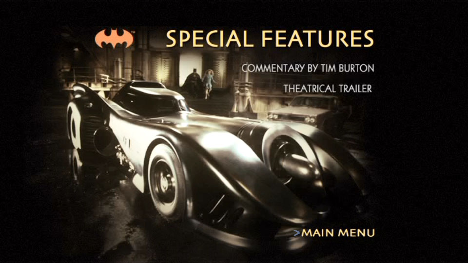

    May 2006
    Canada
    hi, here are some image to help to describe what i'm looking for:
    May 2006
    Canada

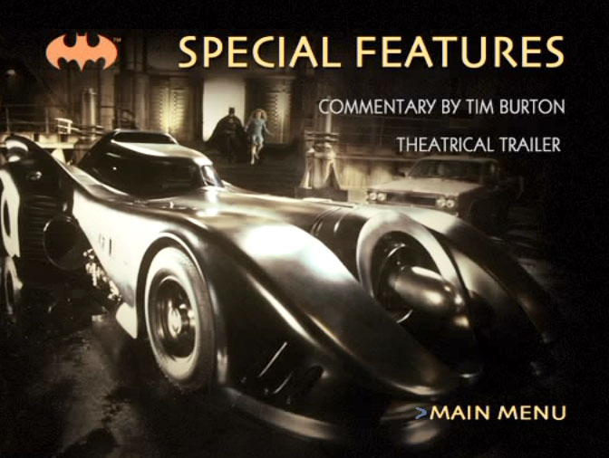

    this is the original format 16:9, but i want the image to go like this when i watch the dvd with a 4:3 dvd:
    and i dont know how to do with dvd architect 4, so if someone can help me, thanks

  10. Member GeorgeW's Avatar
    Feb 2005
    I Just looked and cannot find a setting in DVDA for PanScan. So it appears it can only do "Letterbox"
    Regards,
    George

  12. Member GeorgeW's Avatar
    Feb 2005
    Originally Posted by monks19
    hi, george, could you tell me if pgcedit can do the trick, because i tried, but every time i do it, when i'm watching the video on my 4:3 television, the image looks fine, but the buttons dissapear, but when i'm watching it on my computer, the buttons are there. so i really don't know what do do, can you help me, or can somebody else help me please ?
    thank you
    I don't think you can do it for a menu with buttons. The problem is the original does not include multiple sets of button highlights (4:3 and PS). So when you change it to PS, the corresponding PS subpics do not exist (they are probably there for the 4:3 version).
