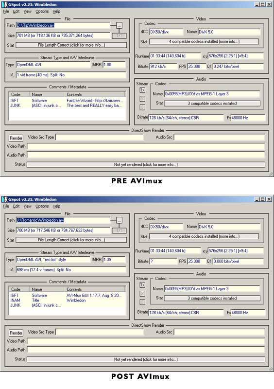

    NOTE: If I run the file through AVImux_GUI, and save them out, they fast forward fine. However they are almost all incompatible with all my friends DVD players. After I run the file through AVImux and then check its info with GSpot the Bitrate and Qf fields in the video section are ? and 0 respectively.
    See attached screenshot for pre and post AVImux of a file.

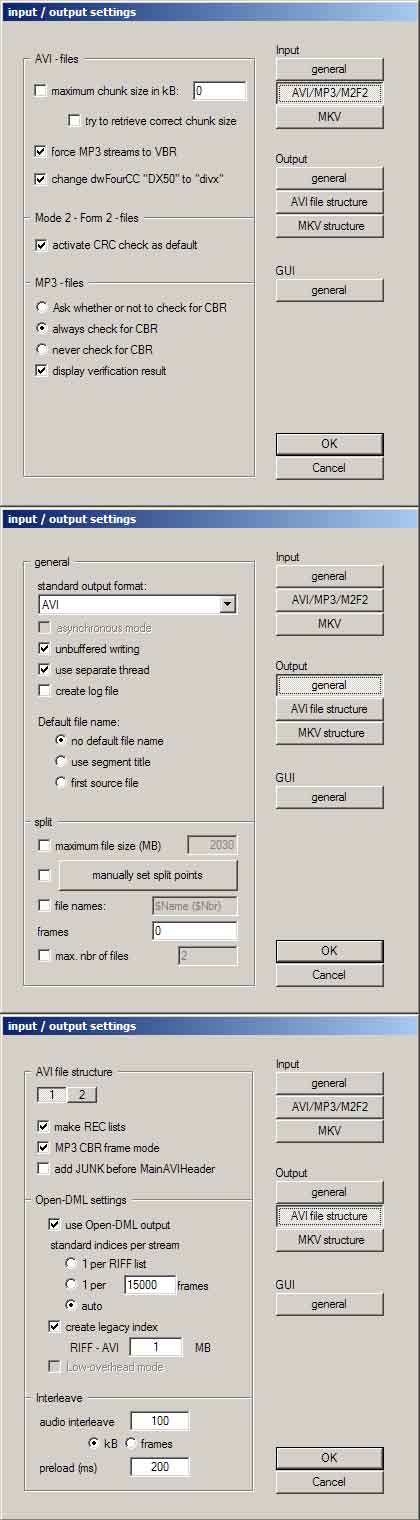

    Ok, what I can see makes it playable is the setting "create legacy index RIFF-AVI" is the player have issues without this additional AVI container information in the file.

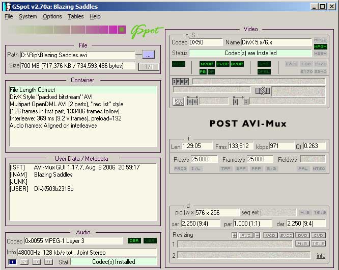

    Could you please use a new version of GSpot. It has some more information, I can only assume that the old version does not detect the openDML Multi-part standard for the AVI container. Most players have issues with multi-part, I'll test if this is the case with mine tonight. Thanks for the information.
  3. Pre AVI-Mux GSpot of an AVI file that DOESN"T fast-forward on the conia DVD player from an external USB hard drive.
  4. Post AVI-Mux GSpot of an AVI file that DOES fast-forward on the conia DVD player from an external USB hard drive.
  5. See the image below for the settings I use in AVImux to get the files to work.
