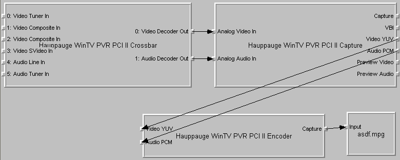

If you don't mind, could you please describe what I have to do in graphedit a little more? This is what I have so far:

In GraphEdt insert the following filters:
WDM Streaming Crossbar Devices -> Hauppauge WinTV PVR PCI II Crossbar
WDM Streaming Capture Devices -> Haupague WinTV PVR PCI II Capture
WDM STreaming Multiplexer Devices -> Hauppauge WinTV PVR PCI II Encoder
DirectShow Filters -> WinTV Cap Writer
The last one will ask for a file name. Set it to where you want to capture to.
Connect the pins like this:
In the Crossbar filter go to the Crossbar tab. In the right half select Output -> Video Decoder Out. In the left half select Input -> Video Composite In. Checkmark Link Related Streams then press Apply. In the right half select Audio Decoder Out. In the left half select Audio Line In, Link Related Streams, Apply.
In the Encoder filter, on the Video Encoder tab, set the video bitrate you want. In Audio Properties select the audio compression.
If you want to see and hear what's being recorded right click on the Capture filter's Preview pins and select Render Pin. That should automatically add the appropriate filters and connect the pins.
Press the Graphedt's record button to record. -

Once you have it working you can save a GRF file. Then start GraphEdt by double clicking on that file and you're ready to go.
But how would I preview video from that latest graph?Originally Posted by jagabo
I'm not even sure I have the link between the capture and the encoder set up right. -
