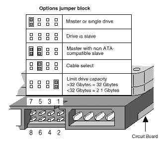

Wrong jumper settings can cause all sorts of problems. I would check them. This is from a hard drive, but a optical drive is similar. Most optical drives have the settings on the top of their case or on the back above the jumpers. If not, you can find them at the manufactures website:
The connector in the middle of the IDE cable is usually for Slave and the one on the end is Master. Some use Cable Select, but then all drives have to be set to that. You may have to switch your jumpers and cable around for the hard drive and the optical drive as some burners insist on being in the Master position or won't function properly. You can only have one Slave and one Master for each IDE cable. -
