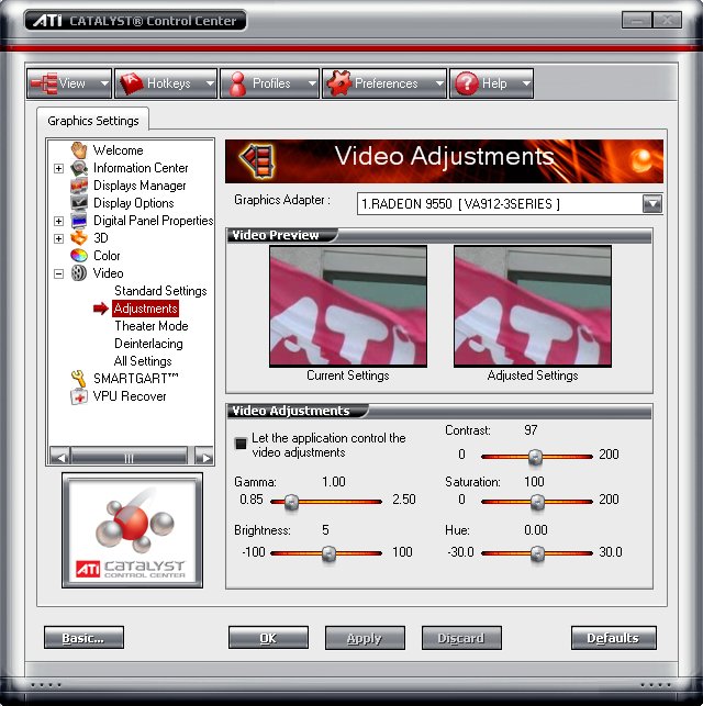

You mean component. The contrast, brightness, gamma and saturation are adjusted in the Catalyst control panel for either output. This picture is for the first output.Originally Posted by jdmbo1
Set black level with "brightness" then white peak with "contrast" and color saturation to personal choice. "Gamma" weights gray scale to dark or light. TV displays emphasize dark grays. -
