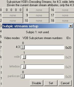

    Open the complete DVD in PGCEdit, the one you Processed in VobBlanker, replacing the old 1-sub DVD with the new 2-sub DVD. Double-click on the movie and a new screen will open up.
    Under the "Subpicture VOB's Decoding Streams" section in the top right, you'll see that only the one sub stream is on. Only the "0" is there, You want Stream "0" and Stream "1", the new Subtitle language. Beside "1 none", move the slider to "1" and hit "Set". If it's a 4:3 DVD, move the first or 4:3 slider to 1. If this is a 16:9 DVD, move both the Wide and the Letterbox sliders (but not the 4:3 one) to 1, and hit "Set".

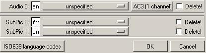

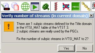

    OK your way back out to the main screen. Up at the top is a green reel of film. Click on it, and it'll give you a message about the number of subtitle streams tracks increasing from 1 to 2. Say "Yes", and in the new screen you can mark it as English, if you like.
    OK back to the main screen and Save it. Now both subtitle languages should be available. Test it out before burning to disc.
