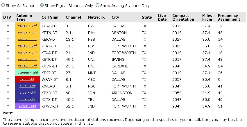

Your over the air DTV stations are clumped in an antenna farm ~37miles and ~203 degrees southwest heading.
http://www.antennaweb.org/
Most of the stations are high power and can be received with a yellow rated antenna. This might work from your deck especially from upper floors.
http://www.tvantenna.com/products/tvreception/tvantennas/winegard/sensar.html
