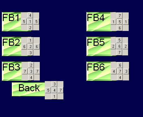

Is there a possibility to add button-order editing within GFD? I have multiple menus to fix at this point, and having to fix them each time I create a DVD sounds like a chore in the making.
Whenever I have menus with two columns of three titles each, with the Back button below the left column, the button order is very odd. Pressing down repeatedly in the left column only cycles the three titles, never hitting the Back button. Pressing up repeatedly only cycles through title 2, title 1, and the Back button, skipping title 3 entirely. Seems like a possible bug to me.
I'm using Muxman, if that matters.
Are the XML button names the same for Muxman as they are for dvdauthor? -

Here's the gfd file for the bug.
I can understand not wanting to add button-order tools, a lot of debugging would be involved. PGCedit is actually very easy to use for this, the UI is nicely done, and I can save/reload the changes I make.
Thanks once again for a great program, GFD is really very solid.
Edit... the button-order problem occurs mostly in MainSubMenu5 and MainSubMenu7, though to a lesser degree also in some of the other menus.
gfd_whatif_11.rar -
Thanks. I will try to find a solution/better algorithm for this kind of button arrangement.

Sorry, but I cannot reproduce your problem. If I use the MainSubMenu5 (with my own gifmasks and movies of cause), I get a 'sensible' button order (in my opinion).
Maybe I have already done something on this algorithm, but not yet published it in an 'official' version. Try the new development version form here: https://forum.videohelp.com/topic310993-120.html#1854201
Here is the result of my test (as in pgcedit)
