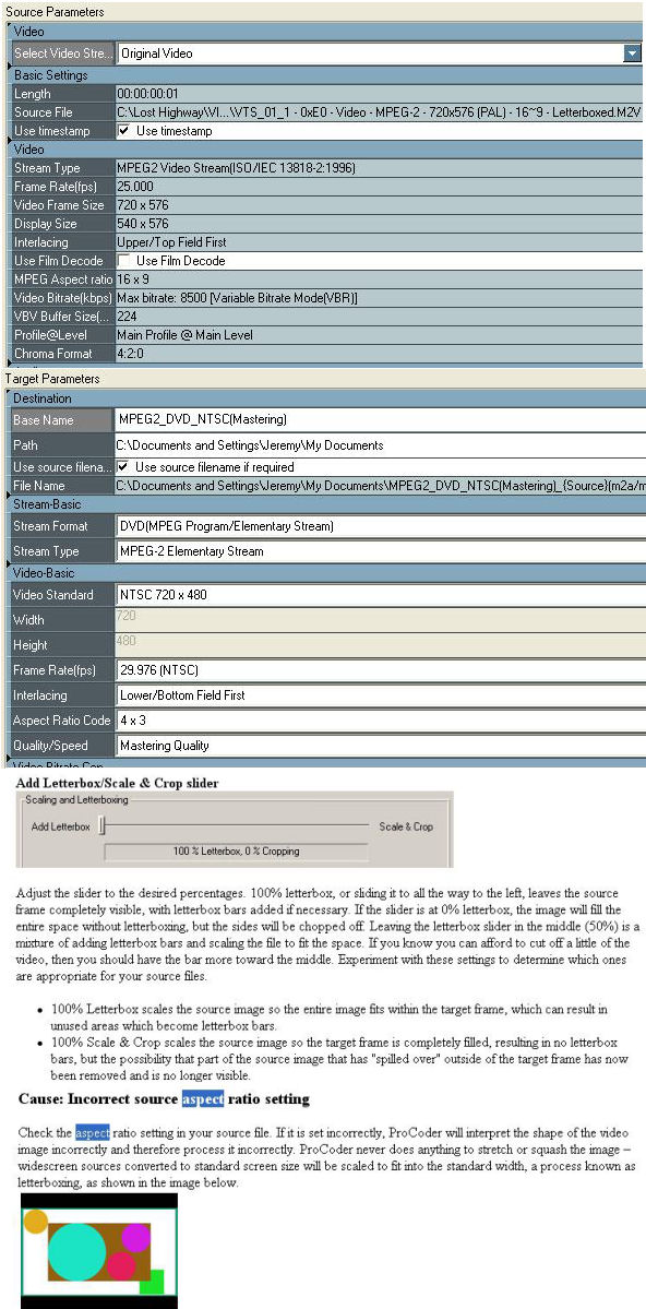

    Can you take a quick look at my attached image file. I took some screen shot of some of the various options I see. The "Aspect Ratio Code" option for both the source and target can be changed to either 4x3 or 16x9. The source has a "Video Frame Size" of 720 x 576 and a display size of 540 x 576 if that helps.
    I'm striving to get as close to what the original size is as possible without cutting off any of the picture.[/img]
  6. Lots of stuff wrong there, but the main one that jumps out is that you reencoded for 4:3, and that accounts for the extra black.
    You also added in a bunch of duplicate frames to go from 25->29.97fps, which will make the resulting DVD play jerky during certain kinds of movement. Much better would to have been to frameserve into Procoder using an AviSynth script and encode for 25fps. Then you can apply a 25->29.97fps pulldown afterwards using DGPulldown. And I don't know why you switched the field order, but maybe it doesn't make any difference with this progressive source. But first things first, I guess.

    In that example (looks like from help file) the input PAL video is a 4:3 image letterboxed inside 16:9 frame and the settings used are for conversion it to full-screen 4:3 NTSC video. The numbers of display size (as I can guess) correspond to cropped size of source PAL image and come from crop settings. That part is resized to 720x480 and encoded.
    In your case 2.35:1 (if you don't crop and make new borders that is also possible) you must have both frame size and display size 720x576, otherwise look for cropping somewhere enabled and disable it. Then the display size of full 720x576 will be resized to 720x480 at encoding. AR setting should be 16:9 for both source and destination.

    I supposed the screen capture was not for that very video (2.35:1) and 16:9 had been used for its destination (4:3 in the picture). Also numbers 540x576 in source settings point at 4:3 pillarboxed image (unlikely a default setting, looks like an example of conversion from manual), strange. Let's wait for more detail from tubularusa.

    I'm sorry about the confusion, but when I made the screen shots I didn't change anything in the target like I did the first time. I was merely showing you what the options are. When I selected the original PAL video and created a target DVD, I did in fact change the target to 16x9, figuring it should match what the source had indicated when I added the video to the source tab.

    The problem with AR you describe could come from setting 4:3 instead of 16:9 (and then authoring as 16:9) but if you are sure it was 16:9 for encoding target...The slider is in correct position; the strange thing is display size for the source video (unless it simply indicates size of program's preview window). Is there any filter for manual resizing?
    The help file (in the extract you provide) reads that scaling (resizing) in Canopus keeps AR. If it is kept in pixels then it will be OK in PAL=>PAL or in NTSC=>NTSC case but this would change displayed AR in case PAL=>NTSC without correction for different target. In other encoders like TMPGEnc Xpress you can disable 'keep AR' to get proper fullscreen resizing.
