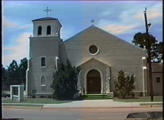

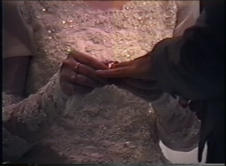

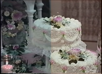

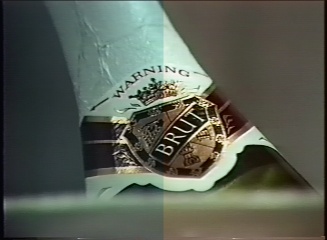

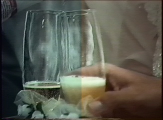

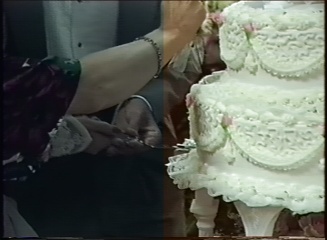

    I am working on transferring a 15-year-old wedding video from VHS to DVD for a friend. The video was shot with several camcorders at different angles, and each camcorder white balance is off. Most of the video either has a bluish or a dark pinkish color cast. Whoever shot this video way back then, didn't properly adjust white balance on the camcorders. So now, 15 years later, it's my job to try and fix it. Inside the church, it also looks very dim at times, like the camcorders iris was closing down.
    My work flow is going from JVC SVHS 9911u -> Canopus ADVC (DV-AVI) -> Sony Vegas 7. My LCD display and my LCD TV have both been properly calibrated using a friend's Spyder 2 Pro calibrator. So what I'm seeing, should be true to what was recorded on tape.
    I would like advice on how to properly set white balance in Vegas. I think I'm doing it properly, but want to verify with you guys. I am currently using the Color Corrector video FX which shows low/mid/high tone color wheels. I choose the complimentary dropper for the high tone, and choose a color in the video that should be white, like the bride's dress. I've also been viewing the RGB Parade to make sure each color is about even on the scope. Is it necessary to also adjust low and mid tones color wheels?
    Here are examples of photos in SPLIT SCREEN mode taken within Vegas. Left side shows uncorrected image, straight from tape. Right side is white balance and color corrected
