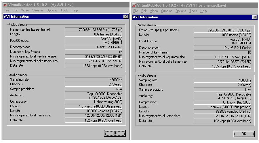

Hi jagabo:
Here are some information I could get from VirtualDubMod's File Information. It looks like nothing was changed in the video part, except the number of total frames.
