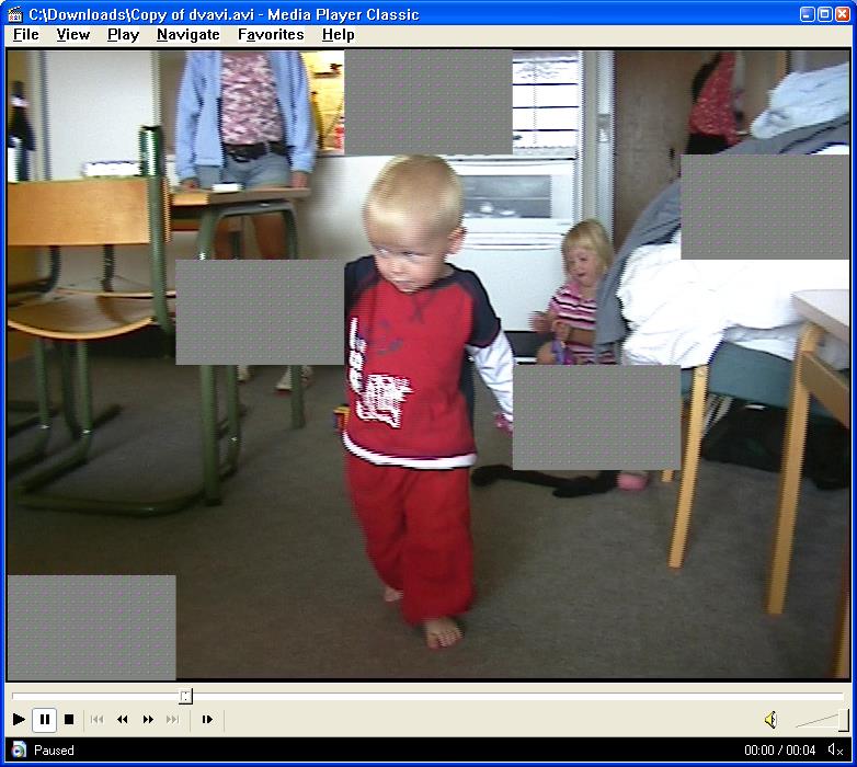

    I've included someone ELSE'S still of a video that they were having problems with. I AM NOT HAVING THE BLOCK PROBLEM...but if you look around the edges of the people, items in the pic, it is the same jagged edge around everything when I capture and burn. And of course it is worse during times when the camera is moving a lot. Some captures with certain programs are better than others, but nothing is great...and I have tried every type of capture setting that I can think of. AVI capture works great, but the files are of course HUGE and then unable to be burned to disc.

    The large blocks indicate a transfer or a display problem.
    Other than the blocks, the raw image will always look that way on a progressive computer monitor. Be sure to encode the DVD lower field first, 29.97 fps (interlaced) and with adequate bit rate (>6000 Kb/s). Use more bit rate if hand held. This will generate a 480i interlace DVD that should look similar at the TV to a direct DV cam playback.

  6. Hi ed - the example frame with the large blocks is from a post last year (I think) which had to do with PAL DV being misinterpreted as NTSC resulting in 120,000 bytes per frame instead of 144,000 - hence the missing chunks of data. I remember it well since the example AVI it came from has been sitting on my desktop ever since I had a poke around inside it(!) Not quite sure why drxpsp9 used it though.
