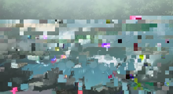

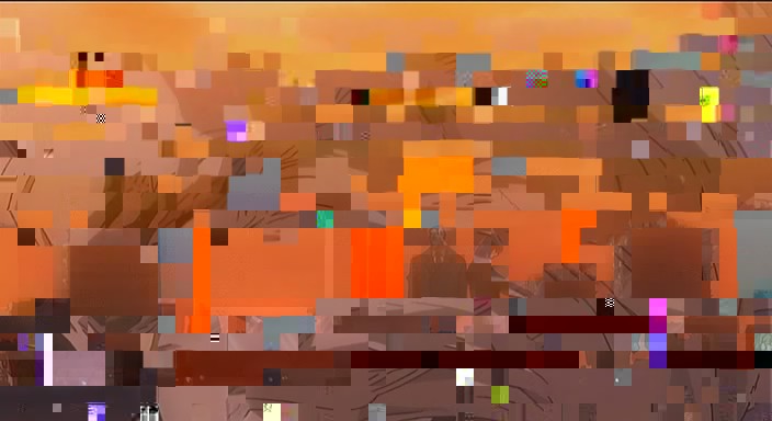

I've got these anime mkvs and i want to convert them into avis. The folks who encoded them used codec DivX503b1328p for video stream (i've got the exact version of DivX from GSpot-v2.52 i01 utility). They also used two aac files/streams for two languages of 5.1 audio. And last but not least a UTF8 subtitle (srt) and a VOBSUB also. Together with the video that makes it 5 streams.
I used these tools with this sequence to convert them. 1.alltoavi v4.14.132, 2.mkvextract v1.6.3 for GUI and mkvextract.exe, 3.wavepad v2.10, 4.vdubmod v1.5.10.2 b2542. I also used mp3gain v1.2.5 for GUI and v1.4.6 for mp3gain.exe (for the normalization of the audio, some of them where really quiet). Those experts in video converting should have figured out what i've done till now but for those who didn't these where the steps.
1. I encoded the video stream (ONLY the video) with alltoavi into avi again. Normally i wouldn't have done that because of the divx codec which can be direct stream copied with vdubmod but i'll explain why i did it in step 3.
2. I ripped the two aac audio streams and the srt sub with mkvextract.
3a. I used wavepad to convert the aacs into mp3s. I could have used the alltoavi to have also converted the audio streams for me but it only converts the first stream in order (i had two to deal with) and it produces VBR mp3 files, i wanted standard lame 128 CBR.
Normally here is where i would have provided vdubmod with the ripped avi from the mkv file and the two mp3s and it would be clear sailing from there right? Wrong! The avi stream had something i can't understand and only can describe it as VBR video stream. That normally shouldn't be allowed by this codec but sometimes i see it here and there. You see normally anime series last 22-25 minutes, depends on the series. This one is a 24:20 one. But when ripped from the mkv, time values change. Sometimes 21, other times 19, heck i've even seen 28mins in some episodes. What this whole mambo-jumbo means? It means that when combined with the mp3 i created earlier the avi produces asynchrony of sound, and that's the encoder's worst nightmare.
Fortunately i fixed that problem by allowing alltoavi to re-encode the VBR divx into divx again, only CBR this time (i don't actually know if this IS VBR video compression, i'm only guessing). And it worked... but it also created another issue along the way, and that is why i'm writing down this post.
3b. I used mp3gain here to normalize the audio.
4. I mixed the streams in Vdubmod. To summarize, the divx avi i've got from the mkv using alltoavi, and the mp3s i've got from the aacs using Wavepad.
Result:
(A river and two guys fishing.. i guess).
(Also here)

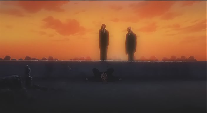

(which is something that should look like that)
(except it's a profile of the last on and also the guy in the middle was still alive.. i guess)
The picture is NOT always like that. Only for a few secs in each episode (about 30 at most cases), but it really is frustrating nevertheless. What i'm saying is that i can live with it, but i sure hope there is another way even more. I've putted too much effort into making these avis, and i've putted even more effort into understanding the whole knowledge on how to do it years and months before that. I'm sure there is a solution out there somewhere. There always is.

Sounds like the video is VFR (just about always it will be VBR). avi doesn't support VFR so the length changes. To further clarify, the artefacts appear only when you play the final muxed file? Or they are in the avi from alltoavi before muxing?
You can create I frames by only re-encoding the section around where you want it, but you can't do it without re-encoding something. Xvid for instance allows you to set I frames at exact frames using zones.
What you might want to try is Haali's mkv2vfr tool. This will extract the video to an avi along with a timecode file telling you what sections run at what framerate. Then convert to a single framerate, either ~120fps or convert say the 29.97/30fps sections to 23.976fps.

No I mean that the video would be both VFR and VBR. The reason why they encode VFR is because the source for anime is often VFR. So they are doing it so as to not destroy the source, not to make things tricky or to protect anything.
Ok, i used the splitter in cmd line like this "D:\mkv2vfr 14.mkv 14.avi. It provided me with an avi of 25.24fps which had exactly the same duration that should have had, 24:20secs. But when i tried to mux the mp3s on it, it wouldn't synchronize. There where no artifacts in the file, but there was also no compression to begin with. I guess that's entirely up to the alltoavi program and its bugs still has as a beta. ln any case, now that the splitter failed too it's all i have left as an option.
-Good Things Come to Those Who Wait- -
Well the length is correct because it has the correct average framerate. Converting VFR to CFR like that won't maintain sync throughout the file as you just found out. You need to look at the time code file. This will tell you what sections are supposed to be what framerate.
