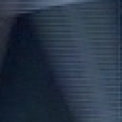

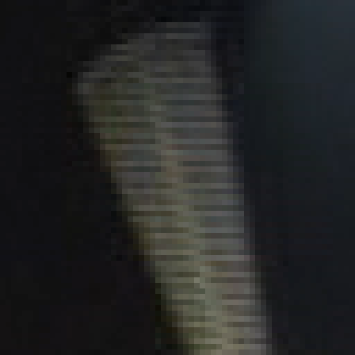

I'm not sure there's any reason to believe XBMC will do anything useful with interlaced video.
Your m2v file was resized after weaving. Or possibly the source wasn't progressive (which means you resized woven material, the same thing).
Here's an 8x enlargment (nearest neighbor) of properly interalced video:
Notice how the fields are contained in exactly every other scanline.
Here is the drumstick from your m2v file enlarged 8x:
The two fields are comingled. This is what happens when you enlarge interlaced video improperly.
Here's the first video scaled as if it was progressive (equivalent of reducing 720 scanlines to 576 scanlines):
Note the similar pattern of comingling. -
