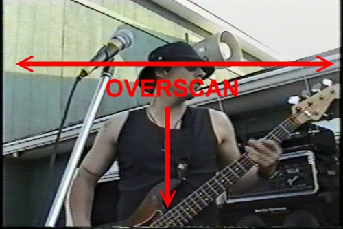

How big is the line? A few pixels and its just overscan:
Can you see this when you hook the cam directly to the TV? This is the first place to start and the reason I'm asking this question has nothing to do with overscan.
