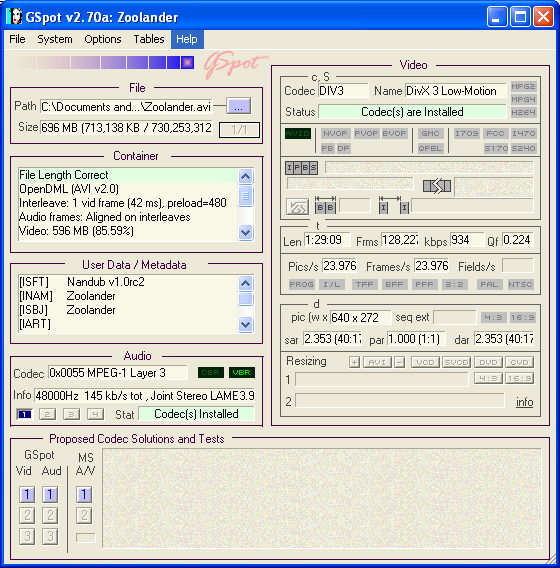

Dose the original file ... not the dvd ... play back on pc fine ... yes / no
If yes , check file with gspot ... your looking to see if audio is VBR ... bad stuff that , trips up many programs during conversion .

Audio , over to right , and down is VBR , in green ... thats caused it

Now , under audio , select wav ... locate the one just writen outOpen the avi in vdubmod. When you get the VBR warning, answer yes to re-write the header. Go to streams->Stream List. Full Processing mode. Set compression to Uncompressed PCM and save Wav.
Set audio to direct stream copy
Set video to direct stream copy
Save as new avi ... it will be bigger , but the wav file should not cause any issues with that cucusoft product ... by taking audio compressors out of the equasion .
