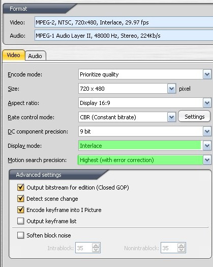

    Here's an example of converting MTS to Mpeg2
    The AVCHD source
    00003_cut2.mts
    The MPEG2 Result
    00003_cut2.m2v

  6. Originally Posted by JOHNTOUPS
    Looks good. How are you converting it to a m2v file? I must be doing something different by converting to mp4.
    For one thing he's using a much larger frame size, 720x480. Your MP4 clip was only 352x288. When both are blown up to full screen size his will be much sharper.
    Secondly, he's using a much higher bitrate. AVC is more efficient than MPEG2 but you're still using too little bitrate for your material.
    It's hard to tell from the small sample, but it looks like it was originally interlaced video and has been deinterlaced by a not so good method.

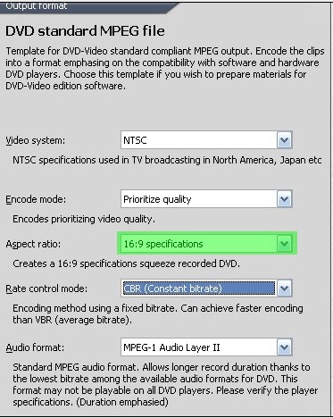

  7. Member Soopafresh's Avatar
    Jan 2004
    Not too many modifications - Just the stuff in green has been modified from the default settings

    If you're encoding to MP4 AVC, try these settings as an example
    Which gives you
    00003_cut2.mp4
    Feb 2008
    Thank you for the help! Those different options worked nice.
    Correct me if I'm wrong, but by using the output "HDV Format MPEG File" I may get the best picture, but it will create a larger file size?
  9. Member Soopafresh's Avatar
    Jan 2004
    HDV format MPEG2 will give you a big picture, but you won't be able to play it on a DVD player.
    Feb 2008
    "HDV-HD2 Format" created a file which I saved as (.mpg) - I was then able to burn to a DVD using ConvertXtoDVD.
    Picture plays great.

    Can someone explain what is "Motion search precision" listed in TMPGenc? Thanks!
  12. Originally Posted by JOHNTOUPS
    One of the techniques used to reduce the amount of information stored for each frame is to locate blocks of pixels that have moved. Rather than encoding the entire block the encoder can just tell the decoder to move the block from the old location to the new one. Motion Search Precision controls how far the encoder looks for movement. The farther the encoder has to look, the longer it will take. This is the setting that has the largest effect on encoding time. And the slowest settings usually make only a tiny improvement in file size or video quality (compared to the medium settings).
    Feb 2008
    Thank you for the explanation! If I'm reading this correctly, the "low" setting in TMPGEnc will be poorest quality, but fastest.....While the "Highest" setting will be the best quality, but slowest?
  14. Originally Posted by JOHNTOUPS
    Yes. You get the biggest improvements going from Lowest to Low or Motion Estimate Search to Normal. Above that takes much longer for very little improvement.
