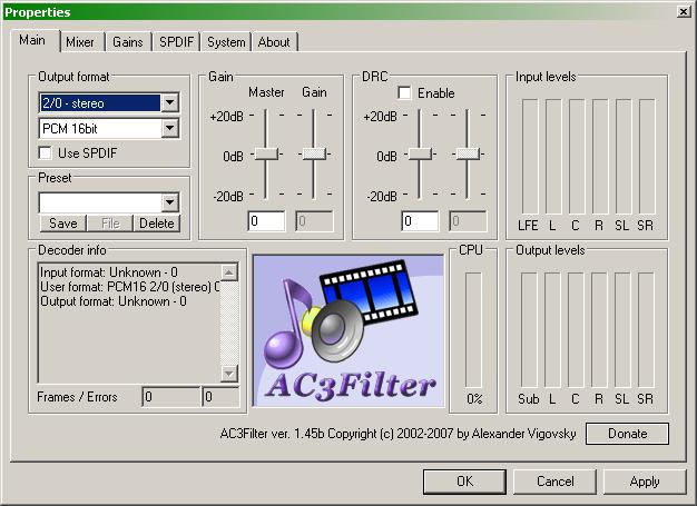

KLite Codec with ONLY MPEG TS Splitter and with AC3 Filter (set at Stereo 2/0) installed.

Google K-Lite Codec Full. It's a free install that installs the appropriate stuff to make the freaking MTS files work.
1. Begin the install and choose "deselect all"
2. Choose H.264 >> CoreAVC
3. Choose MP1/MP2 >> AC3Filter
4. Choose MPEG Splitter >> Haali (TS)
5. Misselaneous >> Detect Broken Codecs
Open your MTS file using Windows Media Player. If it plays, awesome. If not, reboot and try again.

Dear Ran007;
I have bought SD3 recently and was much frustrated in handling AVCHD files. from quite some time i am reserching to play these files but all invain.
You could not imagine how happy i am now to see my files running using your configurations for K-Lite codec. But still there is one problem. There is no Audio to the movie. Could you also help getting the audio from the file.
Many Many thanks in advance -

Dear Ran007;
I tried your settings on AC3 filter but still there is no sound in the video.My sound card is SoundMax HD audio. I have installed the K-lite codec strickly as per your prescribed settings.
If you will be able to help me on this i will be very grateful.
regards -
In fact, AVCHD (AVC h.264) has been used in many of the recent high-def DVDs due to its heavy compression allowing for more video per a given storage space. Early high-def DVDs were based on MPG2 which takes lots of space.Originally Posted by ran007
Better software and hardware eventually make AVCHD work as well as MPG2. -
Hard to say then... See if by going back in the KLite installation, and choosing all of the audio codecs to install won't fix the issue. It shouldn't hurt anything (from my experience). Reboot, then play the file.

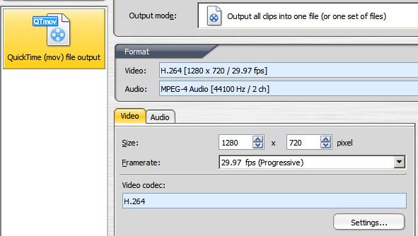

First off, great thread and you've got me halfway home so thanks.
I have a Sony 1080i camcorder and I've shot at XP quality. Looks great on my 1080p HDTV when the HDMI cable is connecting it. It's hi-def, 1080i, looks fabulous, no question.
I have an Apple TV that's capable of 1080i resolution.
Now, I followed the TMPGEnc4 steps as discussed/detailed amongst the group, but I've hit a roadblock as follows:
1. The .MTS file has a native resolution of 1440 x 1080. Says so on the TMPEGEnc4 Source window.
2. My settings are: MPEG4 AVC Format, Bitrate 1500
3. The image that TMPEGEnc4 creates on my HDTV doesn't fill the whole screen. Has a thick black border on it.
4. This smallish bordered image, while nice, is not even close to HD quality. Looks great on my iPod Touch, in fact. If that's all I wanted to do, I'd be thrilled.
5. I'm using the trial version of TMPEGEnc4. I let the K-Lite Codec Pack put every codec known to man on my system. Not sure which ones TMPEG4 is using for the encoding, but it's working nicely if I wanted a small, non HD image on the TV.
On the AVC submenu, the default resoution is 720 x 576. It won't let me increase it to 1440 x 1080. Is that the problem? If so, how does one change it? Do I need to have the paid version of TMPEG4 to do this?
Furthermore, if I choose a Quicktime file (instead of MPEG4) I can convert the file to 1440 x 1080 and even get it into iTunes, but it won't sync to Apple TV. Instead, it lets me "convert to Apple TV format" at which time it downconverts it again to 720 x 576.
What I'm trying to do is simple: I want to shoot in 1080i and convert the files to something Apple TV compatible that is also in 1080i HD resolution. I don't care about file size or conversion time. I just want to build a library of home movies in 1080i on my Apple TV.
Can anyone help me here?
TIA
BJ -

But yeah, I notice the same error you're experiencing in Tmpgenxpress - 720x576
Try the Quicktime output perhaps?
Thanks for responding. I did try the QT output, but that output only is in a MOV format not the MP4 format that Apple TV requires. An MOV file will look gorgeous in 1080i (or 720p if you will) within iTunes but will not move over to Apple TV. Apple TV makes me convert it to a SD fugly file.Originally Posted by Soopafresh
BJ -
