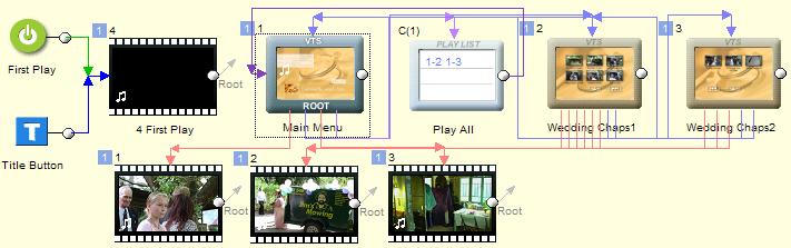

Here's where I encountered my first problem: From the main menu I checked out the links by using the "Simulation" function and the links, though there and confirmed, don't work - nothing happens. I figured I'd build the rest of the project - including a play list - before looking into it.

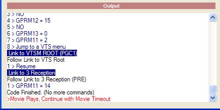

I investigated the non-working links using the VM debugger and came across problem number two: the debugger follows the links (strange and annoying), but when it gets to the play list it repeats the second of two items.
Here's my project set up for problem 1:
And the point at which problem two manifests itself:
...is it something to do with the "Resume" after the "Link to VTSM ROOT (PG1)" line? If so, how do I fix it and prevent it from happening in future?

	Can you post a "Report" of the DVD (Project / Generate Report / Links and Commands)?
 Regards,
 George

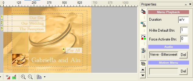

	Is Main Menu a motion menu - just noticed its Timeout=0 (not sure if it means anything during debug mode)
	No. It's a PSD file with a number of layers becoming the buttons in the DVD menu. There's a audio clip and the "Properties" of the Menu Playback has the duration of the menu as "a/v" - I believe meaning it's the same as the duration of any audio or video.Originally Posted by GeorgeW
 Thanks for taking a look - it's appreciated.There is some corner of a foreign field that is forever England: Telstra Stadium, Sydney, 22/11/2003.

	Panic over. I've been doing some more hunting in the DVDLab Pro forums and came across this.
 Just in case the link breaks, the resolution is: "On the Menu menu, there is a Follow Links command (actually a checkbox toggle). Is it checked?" - It needs to be.
 The link describes my problem exactly and it solves both issues I was having. All sorted!!!There is some corner of a foreign field that is forever England: Telstra Stadium, Sydney, 22/11/2003.
