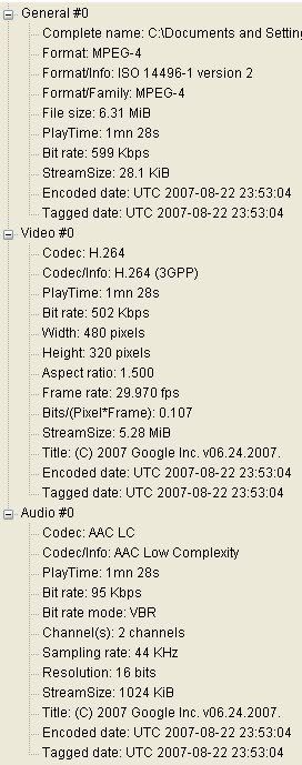

  2. Originally Posted by 45tripp
    if anybody has ever seen a youtube video with a resolution higher than 320x240,
    let me know.
    if anybody has ever seen a youtube video with a total audiovisual bitrate exceeding 350kbps,
    let me know.
    http://www.youtube.com/watch?v=PNJgVilhcBw
    but hey, they are "universal" so they probably have some special deal with YT.

  18. Member vhelp's Avatar
    Mar 2001
    New York
    Hi guys.
    Ad's on youtube, you gotta be crazy!
    I've been pretty busy in all my video many video (programming) projects and things that
    I got bored and took a break from it all to browse around the forums here (and at work)
    and here I am (back) with an odd finding regarding youtubes latest nonsense. I can't
    believe its true, or is it not. Anyway, I'm speachless and confused, so I'll let the pic
    below explain it
    fwiw, I'm on dial-up and so i am guessing that the 320x240 resolution is still in effect
    in lue cause of this. Never the less its still all nonsense to me, and now my head hurts
    so much that I think i'll retire from all this youtube (nonsense) confusion for the time
    being.
    I mean, good quality, bad quality, less quality, oh my..
    -vhelp 4569
  19. Member vhelp's Avatar
    Mar 2001
    New York
    I just wanted mention a few things here..
    As some of you may already know, youtube is now offering higher quality videos.
    However, in order to be able to take advantage of the higher quality videos that youtube is now
    offering, you will prob want to upgrade your flash plugin version. I could not see the benefits that
    everyone here was raving about until I D/L'ed and installed the latest plugin, below.
    The latest version that youtube is using is: 9,0,115,0
    --> to check your version: http://www.adobe.com/products/flash/about/
    --> player download center: Adobe flash player v9,0,115,0
    Once the plugin is installed (you have to close down your browser window) the plugin will be in
    effect when you load up your browser window again.
    I'm using Opera v9.24 and I can finally see the difference. Not all that great (cause all the videos
    I have seen so far have been made by newbies of the video relm) but can be much better, given
    the enhancements offered by youtube. I've commented more on this, below.
    As far as quality goes, well, I can't completely agree that the videos are so called, higher quality.
    Well, they are in terms of certain attributes, but the bottom line here is still true, that the real
    fact is, the users (of those videos) are still beginners in the things of video encoding. And as
    such, the quality of those videos (based on what I have seen so far) is lacking. There is
    much room for improvement. But to take advantage of this next level, some skills need to be
    learnt. And that comes with practice and time, yada yada.
    Unfortunately, with this new (HQV) feature comes a price. That price is in the form of ads that
    get imbeded into the video that is streaming in one's "windowed" player. See my earlier pic of
    this, above.
    The ad (or, commercial) is un-avoidable though only when you have the higher quality videos
    enabled. That is, when your flash player in your browser's window is the newer version from
    youtube, not the Adobe flash player posted above -- the one that is v9,0,115,0 latest. The
    player that changes according to the users selection of the higher quality option is the player
    that I'm refereing to. When that player is loaded up in youtube, then you will see a flash
    advertisement to your right. It is that ad that gets embeded inside your streaming video.
    The commercial can be spotted by the YELLOW marker in the timeline. It will only show once,
    (and whenver you scroll or jump around before/past the yellow marker) but that is too much,
    especially when the commercail has already been played (to your right) and is still there!
    Go figure!
    Videos that are LQ (low quality) will not be effected. I guess something's gotta pay for the
    new features and prob add'l pay load of videos for watching, etc. Oh well
    (note, this tip I got from reading around here on this forum)
    The next thing you want to do is go log into your youtube account and select your [MY Account]
    link, and scroll down to the bottom where another link has to be selected, [Video Playback Quality]
    and then choose the option:
    --> (o) I have a fast connection. Always play higher-quality video when it's available.
    Then, if there is a video that is in HQ, then that will most likely be in the newer HQ video player
    and be available for your viewing at the time of the streaming. If your video window is the newer
    ver by youtube, (not the flash plugin ver) expect to see a commercial, at least once.
    -vhelp 4570

    Now that YouTube is starting to release higher quality flash videos ( &fmt=6 ) and mp4's ( &fmt=18 ), I've been trying to get one of those through the system without being reencoded, with no success so far.
    If anyone else gets it, please let me know!
    I've been sort of working on this too. And I was going to post latest info, but now that you
    threw a screw into it, I'll delay it till I had the time to re-review what I've found so far. In
    any case .. anyway .. per your last statement, I didn't know that the following were such:
    --> &fmt6 was for flash, res/video: TBD (i don't know what they are)
    --> &fmt18 was for mp4: 480x360 res, AAC 125kb audio, ...
    So, I've been going about it all wrong I thought all the videos were h264 (mp4) now.
    But I don't know what the specs are for the newer flash (flv) format on youtube is.. anybody
    know what they are ??

    Yeah - I can't get the fmt=6 (flash) videos anymore either. They may have abandoned flash for H264. Anyway, here they are:
    I suspect what we need is H264 in ASP and AAC sound with a higher max bitrate (than the previous 350k). I've seen different aspect ratios/frame sizes, so I don't think that is a factor.
