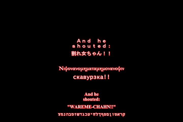

The subtitle picture that I posted to the thread mentioned above
was generated with a script that called only two codepages, namely
ANSI(code 0) and Japanese/Shift_JIS(code 128), notwithstanding,
it was able and sufficient to display Greek and Cyrillic characters
as well, simply because basic Greek and Cyrillic characters already
are a subset of Shift_JIS. On the other hand, the picture shown below
was gotten from a script that (appropriately???) called five codepages.
I hope these considerations can be helpful.

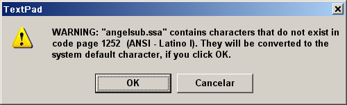

Time for another overdue correction:
Not at all. Vsfilter does not care whether the Unicode file is--- Unicoded subtitle files MUST be "little-endian"
{byte-order mark = FF FE};
little-endianed or big-endianed, as long as the first two bytes
of the file are a Byte-Order Mark. And now, at last,
appears the actual source of my current problems with subtiles: TextPad!
The damn text editor by default does *not* write the UTF-8/Unicode BOMs!
The solution I have found: I'm moving to Microsoft's Wordpad!
