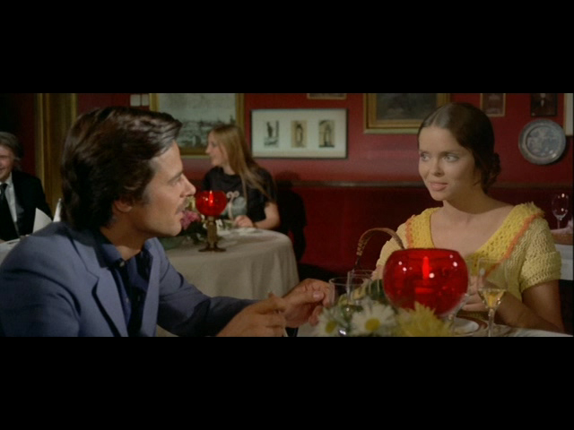

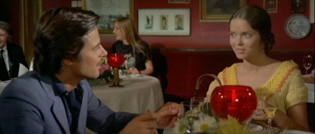

    Here is a video frame that is 640x272:
    This is what that will look like on a 4:3 TV if you leave it widescreen:
    Now if you resize it so as to make it "fit the screen" of a 4:3 TV then you get the following:
    Now you know why home video widescreen versions of movies exist.
    http://www.widescreen.org/
    So in short ... leave it widescreen.

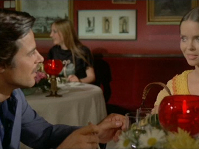

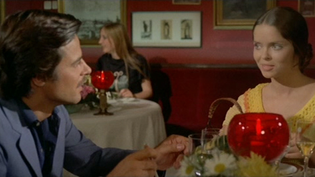

    Here is the same example again:
    This is what that will look like on a 16x9 WS TV if you leave it widescreen:
    Now if you resize it so as to make it "fit the screen" of a 16x9 WS TV then you get the following:
    Not as "bad" but still missing some of the picture.

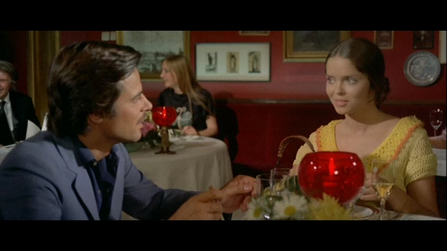

    Ok, here's what I got using your info Fulci:
    Obviously, I'm missing something here. Either I'm not setting the correct flag in the MPEG tab for VisualHub to maintain 16:9 aspect ratio OR instead of putting the crops on the top and bottom, I should've put the crops on the right and left (I say this because the crops showed up on the right and left side when I clearly specified top and bottom).
    I don't know....all I know is that I'm getting really frustrated trying to get this stuff right. This is 5th time that I've tried to encode this clip.......

    When I click on your pics, I get taken somewhere that wants me to register. I can't see the pics clearly. However, if that pic is of the unresized 720x480 video, then people are supposed to look tall and thin - that is, they're supposed to have bad aspect ratio. You're encoding for 16:9, and when made into a DVD and played, the player will resize it to 854x480 (480 x 16/9 = 853.33), making everything look "normal" again.
    If it's 720x400, it looks to me like a bunch of black was added to the sides, rather than above and below, so whatever happened, it's still messed up. Maybe a real MAC guy will come along soon and help you out.
    Aug 2006
    I'm not a Mac user either, but it looks like you've cropped 40 off the top and the bottom, rather than added borders. Set those back to 0 and try this in the "Extra ffmpeg Flags:" box on the bottom right of your picture:
    -s 720x400 -padtop 40 -padbottom 40
    I don't know if the "-s 720x400" is needed since it's set in the box above. Maybe some Mac/ffmpeg experts can lend you a hand.

    So as manono pointed out my math was bad BUT you also cropped instead of added so you made two mistakes. You used my bad math and then cropped instead of added.
    I am not familiar with that program you are using but try resizing 672x272 to 720x352 and do no cropping. The program should add the black to the top and bottom to "even it out" and make it 720x480 in total.
    If you want to try the suggestion by Squash then you need to adjust the math as follows:
    -s 720x352 -padtop 64 -padbottom 64 instead of -s 720x400 -padtop 40 -padbottom 40
