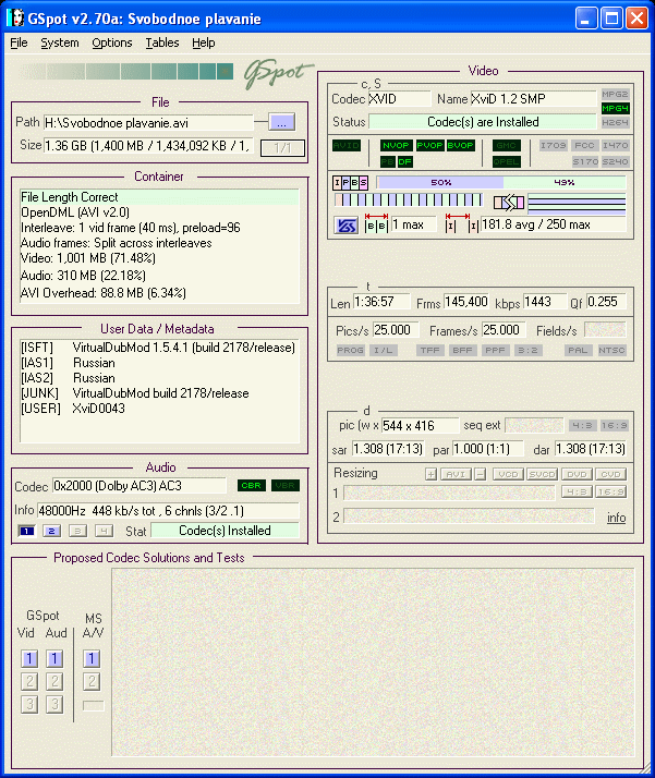

I have this one movie which plays with wrong colors on Philips DVP642. However, the colors are not completely wrong, so you don't notice it immediately, at first it might seem as there is not enough saturation, but then you notice that peoples' skin is blueish... The movie plays with no problems with great colors on PC by various software players... I tried recompressing with VrtualDub using different settings and every time I get exactly the same result... I will appreciate any ideas.

For a temporary fix, you can try pushing the System Menu button on the remote twice. However, the bluish tint is due to the use of custom matrices in the AVI, and it would need to be re-encoded to get rid of the problem. You can use AutoGK (in ESS compatibility mode) or AVIRecomp to recompress the files so that they might work better on the 642, if necessary.

I tried re-encoding with VirtualDub, last time using DivX6.something coder, but still got the same tinted color... I'll try the tools you mentioned... Thanks.Originally Posted by Ai Haibara -

At the moment, the only way I'm aware of is to use a utility like GSpot or MediaInfo, and make sure the AVI fits the following criteria:
Video:
Encoded with DivX/Xvid. (Of course.
) No packed bitstream (GSpot uses a 'PB' indicator for this), GMC or QPEL encoding. Should be about 720x### or less (DVD resolution, maximum.) There may also be a bitrate maximum, but I'm not sure what I should recommend, offhand.
Audio:
MP3 audio stream, should probably be within the 128-320 bitrate range, but I've seen lower work with the 642 (no guarantees). VBR audio may or may not be a problem.
