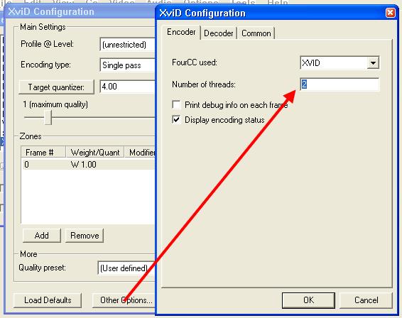

Thanks for the pic. Tried it, but I am still getting the same skipping problem.
Tried it what? I was just wondering if you were using Xvid or libavcodec's MPEG-4 encoder. Because Xvid is Xvid and the only reason it would be faster in ffdshow is because these days they bundle xvidcore with it and it would be a 1.2 CVS build. Won't be any faster than a 1.2 CVS build of Xvid itself though.
I have been using libavcodec and have been having trouble getting it to play on the dvp642. I tried switching to xvid like the pic you posted, but i was getting similar results. This morning I tried libravcodec again, but this time I left number of threads as 1 and got it to play on the dvp642. Thanks everybody for all the help.

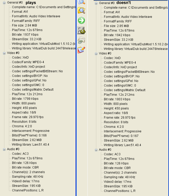

Could you upload some small samples of your files that play and don't play? I'd like to take a look at them. -
jagabo: I will pm you the link to the files. One plays on the dvp 642 and the other doesn't.

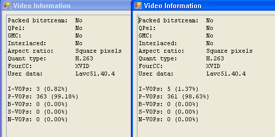

I couldn't find any significant differences between the two files you uploaded. I examined them with GSpot, MediaInfo, VirtualDub, KMPlayer, and a few othe programs.
VideoInfo:
MPEG4Modifier:
The one that doesn't play properly did have a very slightly higher bitrate (~0.3 percent) and sligtly higher peaks in bitrate but I find it hard to believe that is the problem (and you could easily test this by encoding a little lower). The one that plays has a few more keyframes but that shouldn't matter. The one that plays has an all green frame at the start, whereas the other has a frame from another video (an ad maybe?) probably b-frame decoder lag from the source h.264. That shouldn't make any difference but you might try cutting out the first GOP and Direct Stream Copy the rest to see if there's any differnece. -

Use Xvid 1.2.127 and you can enable two threads:Originally Posted by ch4757
