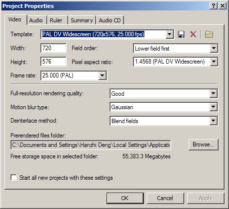

    I've also included some screen shots for ur info.
    Project Properties PAL DV Widescreen

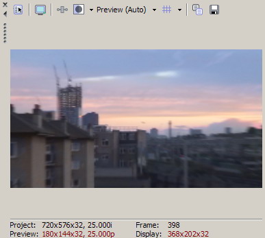

    Preview is right in 16:9 model

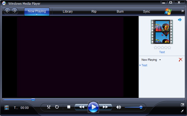

    Playing raw .avi file or Vegas rendered file will result in wrong AR.

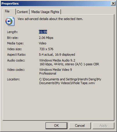

    A video flag is added in the WMM rendered file, well sort of....

    If your DV camcorder is shooting true wide screen, it will be 720x576 and fill the frame vertically (no black letterbox) plus look horizontally squeezed. It should also carry the wide flag but some camcorders don't add the flag or the edit software fails to detect it.
    For Vegas, set project format to DV wide 720x576, 25fps lower field first template. When you import your video, right click on the clip and verify aspect ratio is wide 16:9. If not you can modify the properties to 16:9.
    When you export the file, you must again verify settings. Vegas allows you to encode your MPeg as 16:9, 4:3 letterbox or other aspect ratios.
    I think you are missing that wide and 4:3 DV (or DVD) are both 720x576. The difference is pixel aspect ratio. The pixels are never square at 720x576. If you display it as square pixel, wide will look tall and skinny, 4:3 will look less skinny. The software player stretches 720x576 to 1024x576 for 16:9 square pixel playback and to 768x576 for 4:3 square pixel display.
    Hello guys, I am about to try your suggestion. But before I start I'd like to to make sure whether my Project Property is right? See the image above (or in the orginal post). The pixel ratio is not square but in 1.4~~~ something.
    Basically there is little I can do during the capture process in Vegas, no such settings to define the raw .avi file.

    1. My file (like yours) plays back normally in one media player but NOT in Windows Media Player 11. What's the problem? Maybe it is WMP that hasn't done the right thing.
    2. Can you play the raw .avi file I posted in 16:9 AR in WMP?
    3. I still couldn't render video into 16:9 .wmv or .avi files. They appear horizontally squeezed in any media player installed on my PC. I seriously need to do both coz I normally share videos with mates in .wmv and copy files back to DV tape for permanent storage in .avi files.
    4. My WMP doesn't seem to recognise the "16:9 flag" in the video files rendered by Vegas. So is there any software application I can use to add one to the output just to make sure WMP recognises it?
