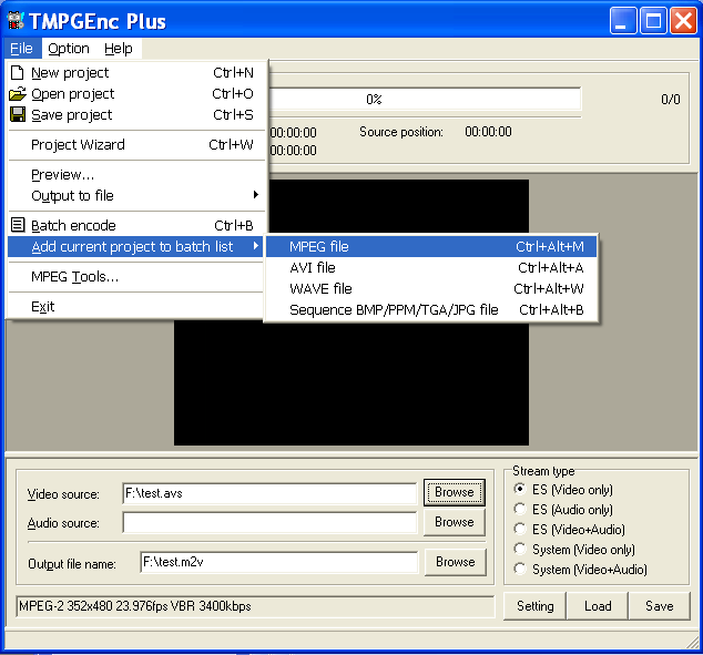

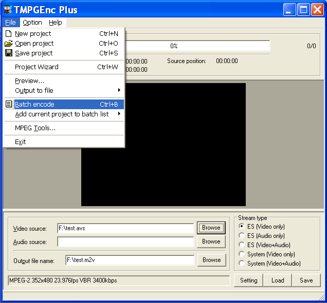

  22. Man of Steel freebird73717's Avatar
    Dec 2003
    Smallville, USA
    Now that I think about it tmpgenc has a batch encoding feature. If that is the encoder you are more comfortable with use it. Set up your encode like normal but instead of clicking encode click on the file tab at the top then choose add "current project to batch list-Mpeg". When finished setting up your encodes click the file tab, batch encode, RUN!

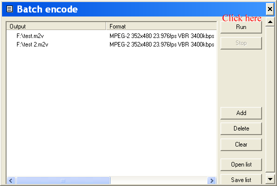

  24. Man of Steel freebird73717's Avatar
    Dec 2003
    Smallville, USA
    Set up the file like you normally would. Don't click start. Follow pictures
    When finished adding files to be encoded do the following.
    Then a new window will pop up. Click run.
    Donadagohvi (Cherokee for "Until we meet again")
