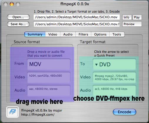

    The easiest way to do what you want would be to
    use TOAST. with toast, you could just drag and drop
    the files from Snapz into it, select Video-DVD, click burn,
    and a couple of hours later be done.
    If I had what you have, here is what I would do:
    take the files into ffmpegx.
    follow along
    now select this tab.
    make sure to choose Decode with Quicktime.
    Click encode, and sit back and wait.
    it will create the seperate files, but
    It will also create your Video_TS folder for you.
    Once done, do the second movie the same way.
    Then Take them into DVD2ONEX and join the two Video_TS folders
    down to one new one at your target size.
