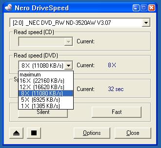

    I am wondering if there is a tool that allows me to lower my DVD ROM Drive speed to keep the laser on track, even if the track is uneven or otherwise in bad shape, so I can copy the DVD to a DVD-R

  5. Nero's DriveSpeed will let you limit the read speed of the drive.

    ... and I just realized that the drive that read the DVD the best is limited to 6x speed according to Nero I manually added 1x and will see if it does any good - otherwise I'll try other drives.
