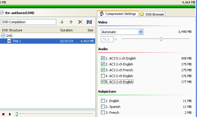

Many times when using DVDShrink I see multiple audio tracks that all say AC32-ch English (screenshot attached with 3 english and 1 french). Is there any way to figure out what these are? I'd like to just not back them up if they are extra and not needed but I don't want to cripple my DVD by removing something I need.
I'm using Reauthor mode and just dragging over the Main Title and just want to delete anything that I don't really need for the movie itself to play and sound good.

Commentary track most likely.
Do a right click in the preview window and play that audio
and see/hear for yourself. -
But is there any way to verify that's what it is? Other than NOT backing them up and hoping for the best when I play the movie?Originally Posted by hech54
Can I isolate those feeds somehow (in Shrink or in something else) and just play them to see what they are?
Ah, didn't know you could do that.Originally Posted by hech54
Thanks.
Just to pass along info.
The first 2-CH track seemed to be the same as the 5.1 just without surround I guess
Second one was in french
3rd and 4th were commentaries by two different people. -

@kelemvor, you can also find and view the 'audio menu' that will show exactly what each audio track is. in your example you may see something like:
5.1 dolby
2 ch. dolby
2 ch. french
commentary by xxxxx on/off
commentary by xxxxx on/offI am just a worthless liar,
I am just an imbecil -
The first file is the largest and ,more often than not, the correct one. I have had this happen to me many times and the above works. Also, testing them as alluded to above should be done-in addition.
