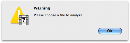

    I've just discovered VideoSpec and until yesterday it worked just dandy. Now it will no longer save a text report of a single avi or a comparison or two avis.
    I've reinstalled to no avail. I'm unable to find the .plist or other pref file I can nuke and I can't find any other app that does what VS does so skillfully. See screenshot for error msg. even when file is loaded <shrugs>
    Any ideas?

    Hi mhale62,
    I am the developer of VideoSpec. I have newer seen this bug before. In fact, there is no pref file in this version of VideoSpec and it is quite strange that this bug appears suddenly. Do you get this error dialog for all files you try to analyze?
    I think that it is related to your system and I suggest you first to repair authorizations on your hard disk.

  10. Member mhale62's Avatar
    Dec 2006
    Bump: I get the above described error when I drag an avi file onto VS's icon in the dock then select Save report.
    If I use the Select File button all works as it should.
    HTH,
    m

    OK.
    I can reproduce this bug ! I will fix that in the next release.
